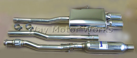

it is the part just in front of the flex pipe that the v-band clamps to.

no, i am going to be building a downpipe back exhaust and need the piece that connects to the downpipe.
I am going to be using a downpipe that fits the stock exhaust, so i just need the piece that attaches to the downpipe.
Is that more clear. its the piece on the exhaust picture i posted that is before the flex pipe.
EDIT: Basically i am building what is in the picture i posted (downpipe back exhaust system), and i need to find the piece that is before the flex pipe in the picture.

@ Whrisk - You need a V-Band flange (weld).comes in different sizes (diameters) you can reuse your factory V-band clamp or buy a new one. Jegs or Summit Racing should have what your looking for.

Seems I was wrong. Looks to be a "ball joint" type connection?

But the clamp on the factory system looks more like the v-band clamp.
More like this....
http://www.ebay.co.uk/itm/EXHAUST-JO...-/261200084309

yes it does look more like that. i have already ordered the one i posted from summit. i am going to see if it will work. if not i may try the one that one.

I bought a 2.5" stainless pipe with a 3" flare similar to this one.
http://www.ebay.com/itm/PFAB-2-5-to-3-304-Stainless-steel-Flare-pipe-16-gauge-/261423568471?hash=item3cde0f1657&vxp=mtrThen coupled it with an exhaust doughnut and the original v-band clamp. Worked like a charm. An exhaust shop can also probably flare the piper for you.
