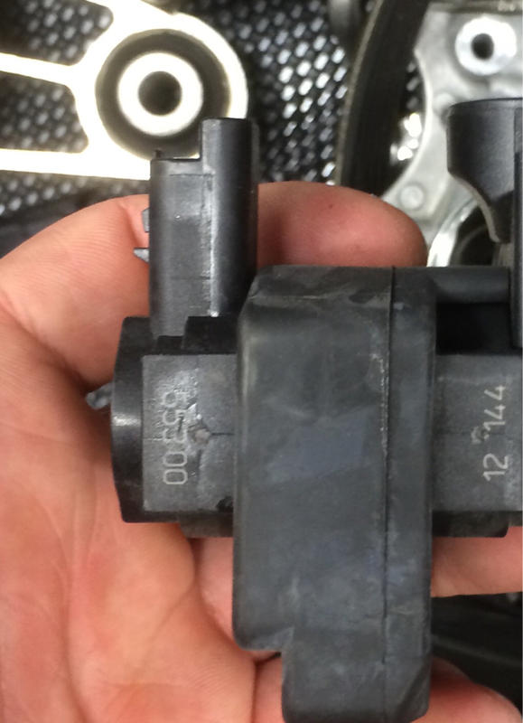

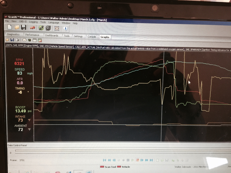

I have been hunting down a CEL code for about 6-8 months now. It is a P2C57 which is common when there is a boost leak on the air charge side. Or when the ECU is calling for more boost but it is not available. I charged the system to 20psi with no leak. I was finally able to data log a variety of different runs and in doing a 60-90 run the CEL occurred which is helpful. Below is a graph at the point I believe the CEL triggered. Manic Motorsport brings us N18 owners OBD II Tuning! Solution is finally here!-image-815609317.jpg The data log is off to Manic. Ran on stock for 1000 miles with no issues.

I have seen something similar in a few tuned cars that boost over 1bar. Have you tried changing our your Boost Solenoid? Mini made a bad batch of these, but it's difficult to say they are bad, because they do hold the typical 1bar. The part is only $89 and I think it would fix your issue
http://www.ecstuning.com/Mini-2012-C...013_2014_2015/

Does the R60 use the same one?
Old Mar 29, 2015 | 02:06 PM
  #1771
wzabrouski's Avatar
wzabrouski
Joined: Jan 2008
Posts: 1,012
From: Keller, TX
Maybe it's time for the JCW turbo.

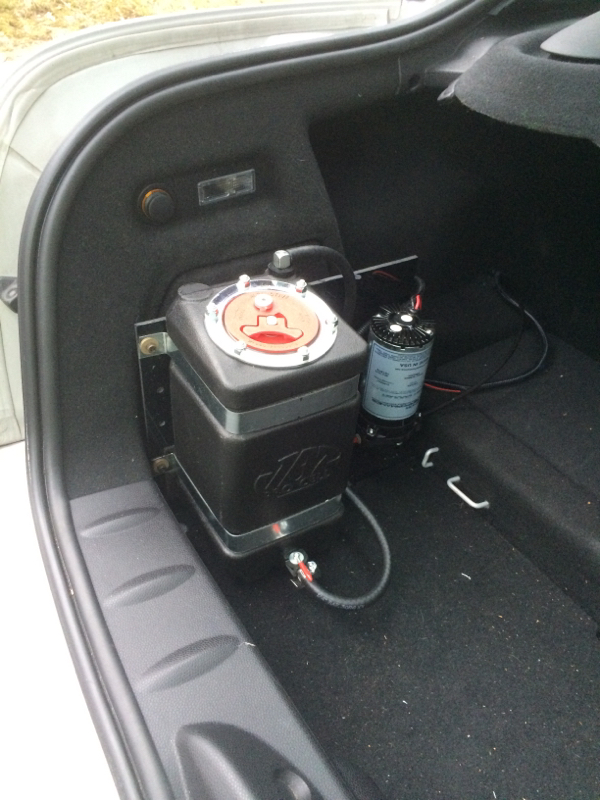

I just got from a run. I installed my new (smaller) meth nozzle and now I'm injecting around 480-490ish ml/mn. Stage 2+ Map B , what a blast
Don't know how accurate the dash command hp and tq numbers are but on last data log, it reads 244hp and 241 tq.
I also installed my new 1 gal meth tank about 2 weeks ago. It's a jazz fuel cell with a vent tube leading outside the car. With my old snow performance meth tank with vented cap, I would get a meth smell in the car. Now no more smell and larger capacity.
Attached Thumbnails Manic Motorsport brings us N18 owners OBD II Tuning! Solution is finally here!-image-1922998826.jpg
I know all N18's use the same, not sure about the N14's.

Originally Posted by sbninja
I just got from a run. I installed my new (smaller) meth nozzle and now I'm injecting around 480-490ish ml/mn. Stage 2+ Map B , what a blast Don't know how accurate the dash command hp and tq numbers are but on last data log, it reads 244hp and 241 tq. I also installed my new 1 gal meth tank about 2 weeks ago. It's a jazz fuel cell with a vent tube leading outside the car. With my old snow performance meth tank with vented cap, I would get a meth smell in the car. Now no more smell and larger capacity.
I thought that much meth was only needed for C on 2+?
Typically meth is only required for 2+ on Map C, but the car can always benefit from higher octane and cooler IATs
