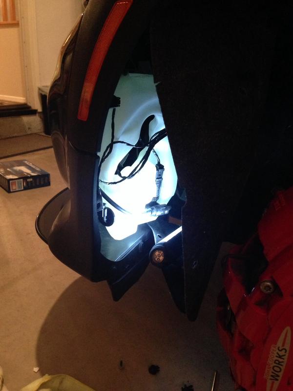

I have had meth in other cars and now considering it in my GP2. Since I have no back seat, and I carry lots of product for work, I don't want to loose hatch space. Has anyone used the windshield the wiper fluid tank? I was looking at it last night when installing my H8 HID's. I have a few questions
1. Where should the pump go, lower than the tank?
2. What kit should I buy?
3. Nozzle size?
4. What psi shiould I have come on? I hit 18psi now after the IC, and DP install.
5. How much fluid does the tank hold?
Mario
