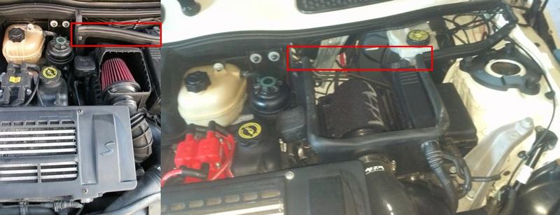

What's this plastic thing you guys are talking about? Thanks!
Old Apr 22, 2013 | 06:48 AM
USCooper's Avatar
USCooper
Joined: Jun 2011
Posts: 187
From: Spartanburg, SC
Check out the attached image. I found the image on the left online and it has the piece we're talking about (looks like this is a JCW intake where someone cut the top of the box open). Mine is the one on the right. Notice that piece is gone entirely.
