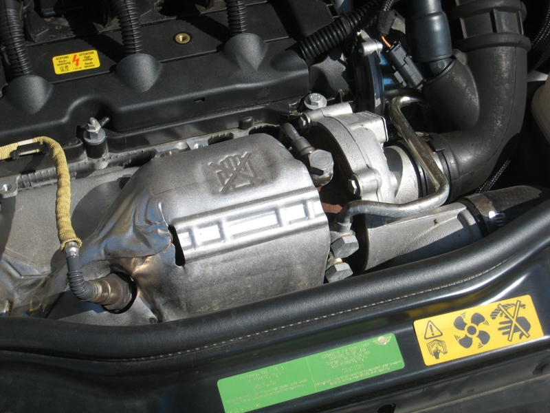

You can't be telling me that your turbo is bare balling it. It doesn't have this:

If I have to get particular w/ you the heat shield on the exhaust manifold. You definitely have that. It covers the turbo housing and the downpipe.
