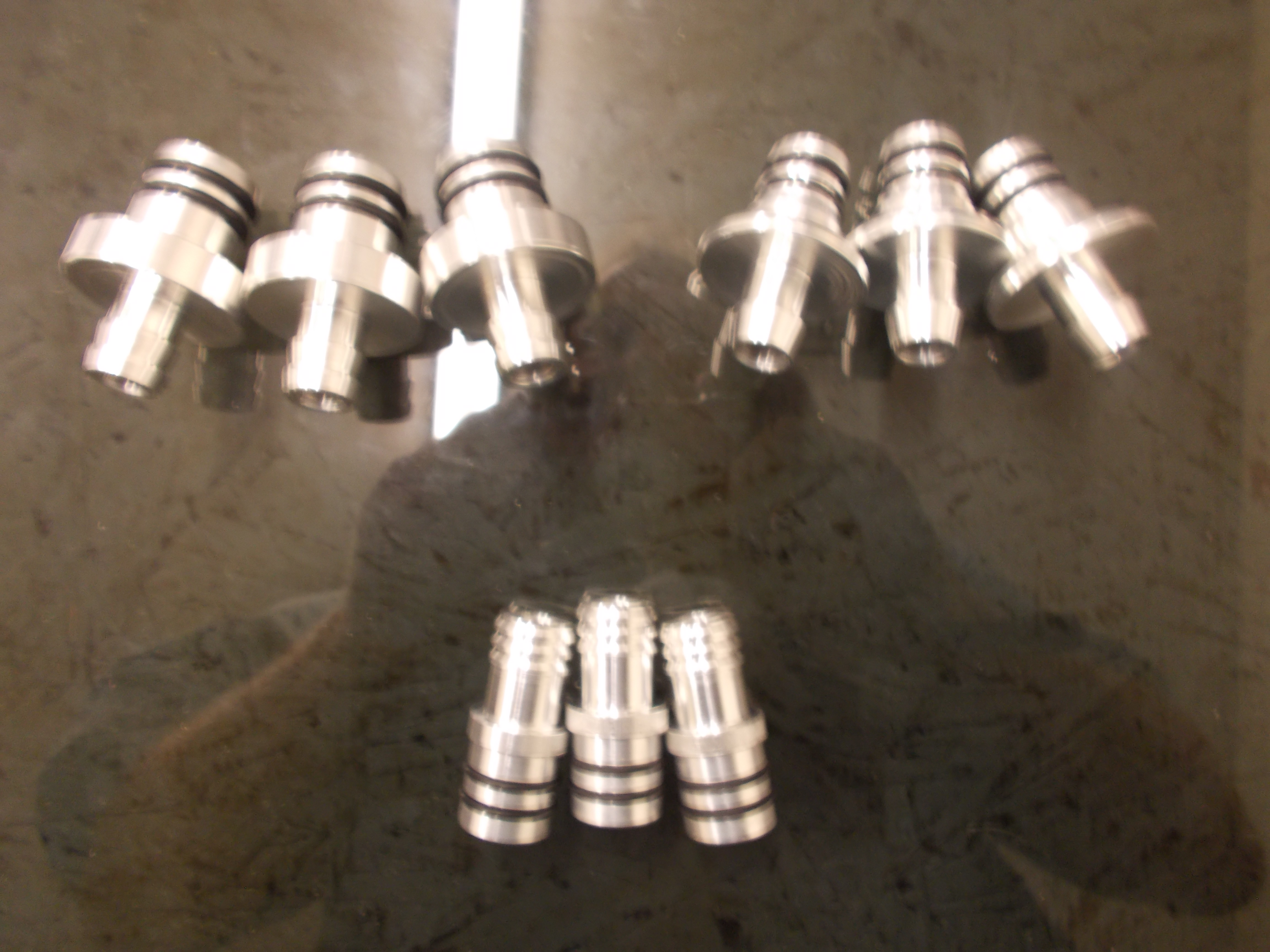

RX is correct. The CNC shop is waiting on a special collet to make the adapters for the N14 and then they will be on the way all!
Great, i hope they dont take too long since i have no occ on my r56 yet and i`m getting anxious.

These are near ready. Just ran the first batch of N14 adaptors at $20 each, so Tommy Liveoak is testing them to make sure no tweaks are needed, then will run full run of them for production.
