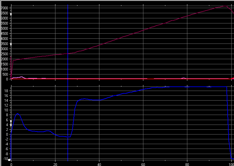

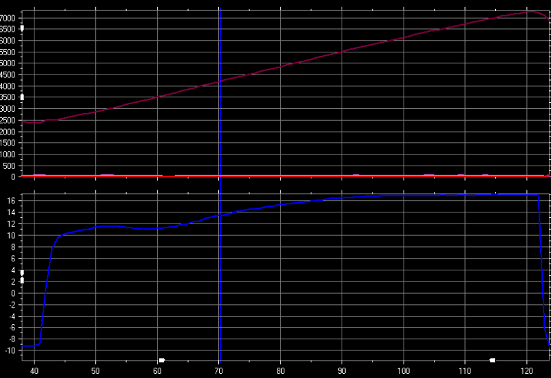

OK here's what I got as far as boost with the two different pulleys:
(top graph RPM, bottom Boost)
64mm (peak 16.9)
60mm (peak 19.6)

of course yours may not be the same but this will give you some idea.
Also, my boost with the 64mm pulley is actually a little lower than normal (should be mid 17's), after the 60mm pulley swap I found out I had mistakenly been using the wrong tensioner piston, so I may have been getting just a slight amount of slip.

Thanks for the graphs. This is nearly identical to what I am seeing so with the 64mm pulley. The boost jumps up then slowly increases. I think I will like the 60mm pulley because of the 2 psi increase in the initial boost . Have you been able to switch the pulley without placing car in maint. mode ? Thanks again for all the input.
