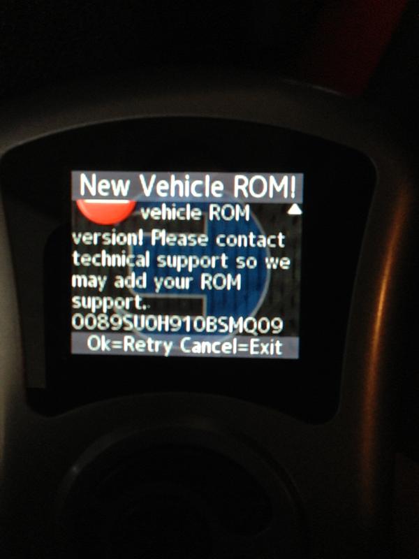

I've had the ECU dealer updated once already and this resulted in the AP not re-installing due to 'New Vehicle Rom' (see attachment). I contacted Alta and I had to update to the software to fix this.
So Alta offering support for 6 more months matters little to me at this point with 35,000 miles and 4 years of warranty left.
Anyone with a car that will still be under warranty service after July 2013 could be in the same boat.
I had a similar experience with a dealer software update, but I was able to "uninstall" the AP first. Since I'm running custom tunes, I couldn't re-install my AP map. One call to Jeff Perrin and he changed the title / name of my maps to match the dealer-installed software --- up and running again.
I expect this service to go away after 7/13, and with maps being "locked" so we can't alter or read them, we're SOL. Maybe we can get the key to unlock our maps?
It would be nice if Alta would core dump every map they've written for the AP and host them on their site prior to them terminating help with the AP. that way folks could pick and choose what they might need if that need arises. That or mail downloads to custers who request it.
This ROM issue really is the biggest problem that I see. It was stated that Alta has seen minimal ROM updates ie. 2 in six months. For those with 2+ years left on their warranties that's actually pretty good odds that at some point your ECU will be updated at the dealer rendering your now unsupported AP useless.

4. I have had issues when getting my ECU updated and trying to update the AP afterward (it reloads the map fine). I have learned to uncheck the box that says 'automatically backup the ECU' when first installing the computer. This allows the AP to update. Then I recheck the box and resave my base ECU map. I don't know if this is what Rockridge has issues with or not.
