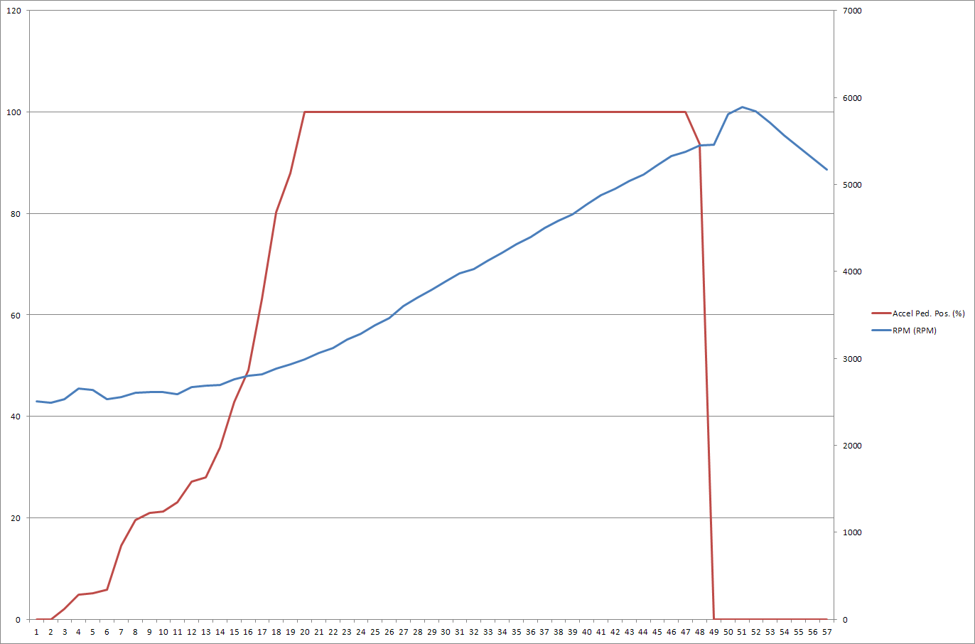

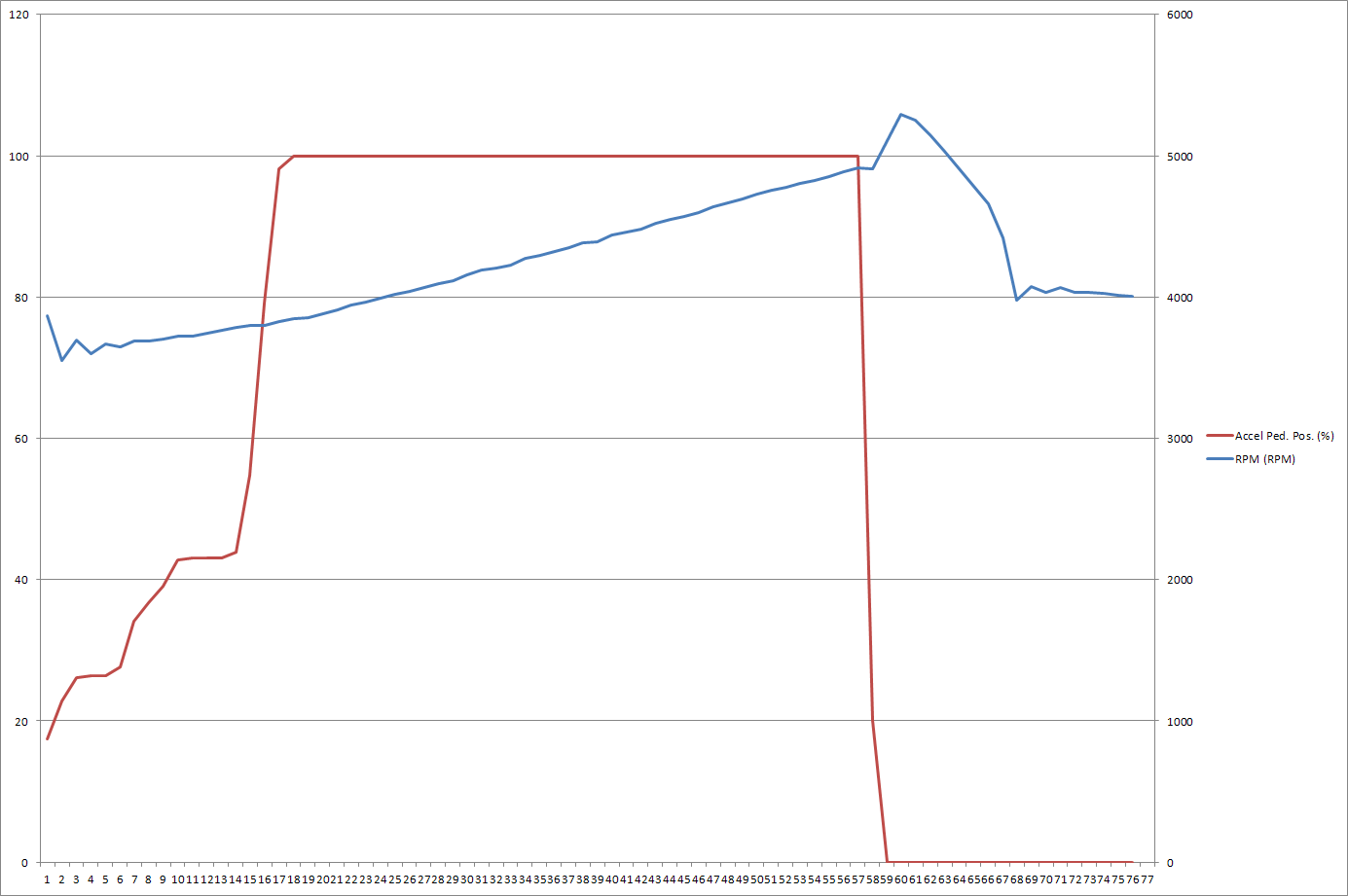

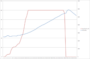

Just got my AP installed, noticed something pretty quickly..
During shifts, the engine seems to hold revs for a second, or.. even over rev during the shift.
I had one instance where I shifted at 6000rpm, but the tach jumped to 6500 before coming down.
Anyone else experience this?

It doesnt seem right. If I was actually shifting hard/fast, I would totally be engaging the clutch before the revs fall again. Its a very slow process/

I took some datalogs today, pretty obvious, here are some graphs of Throttle position and RPM. Why is RPM spiking after lifting?
