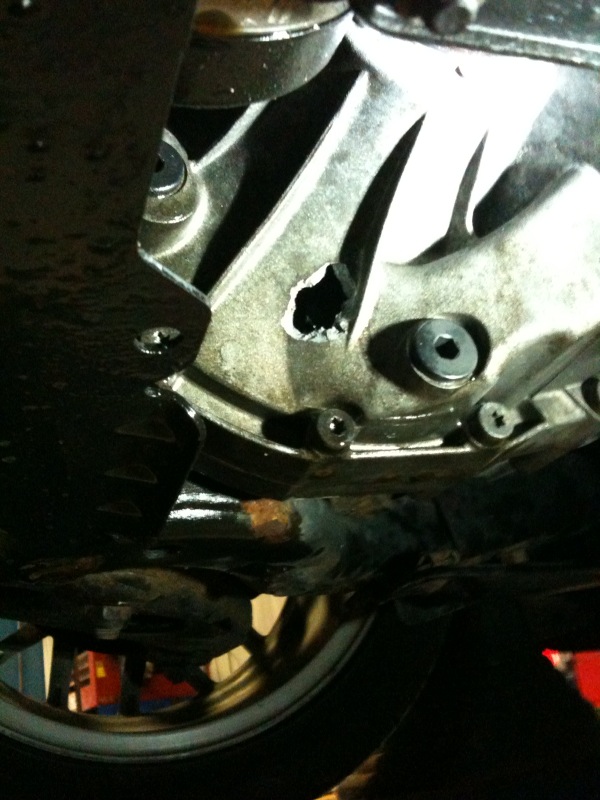

Ok, After picking up my 02 R53 from the alignment shop. I drove about a mile down the road and something flew through the transmission casing.

Pics of the damage so far

Any word on the part that actually failed?

My bet is on the diff pin and/or a spider gear breaking through.
Jeremy
That's what I was leaning toward, but I am really curious to see.

Ok trans is out should have it apart later tonight but here is another pic of the carnage that took place inside the bell housing.Jhiggs was right a spider gear shattered and went through the housing.
