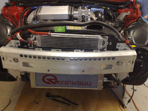

This is my Oil Cooler, it is an Automatic cooler with bigger lines on it. Fits in the stock location if you don't have an Automatic. I have a thermostat on it as well coming out of the Mini Madness adaptor plate.

I like this...the cooler itself is bolted down and secure. The others don't seem to be bolted to anything.

the big downside to that application is it doesn't get good airflow over it.... I had to put my TVS there because I didn't have any other room for it anywhere else
