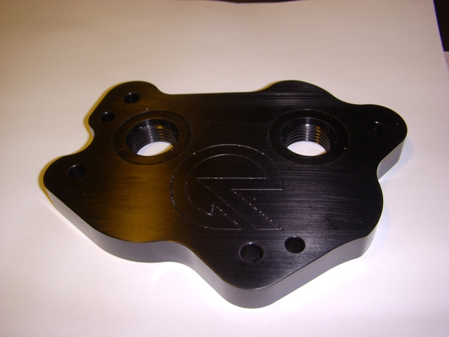

RMW Plate
Here is a picture of the RMW Oil Cooler Adapter Plate:

  #85
SeanKidd's Avatar
SeanKidd
Joined: Sep 2007
Posts: 119
From: NW New Jersey
firewalled, sorry
here is the RMW plate

Old Jul 14, 2009 | 03:47 PM
  #86
//MZero's Avatar
//MZero
Joined: Jan 2008
Posts: 565
The RMW plate looks like a nice piece, similar to the plate I got from Moss Mini, and similarly priced too. Nice to see there is competition for nice hardware, that is not over done or over priced like the MM one.
