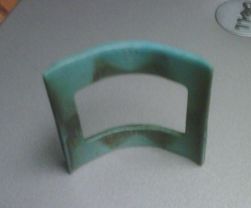

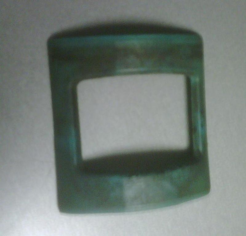

where does this piece go?
hey guys! so i've got a left over piece from doing my engine rebuild. i've attached 2 pictures of what the piece looks like, and it looks like something i would have problems if not installed.
that being said, i am having problems. i'm hearing a clicking noise, like a cv joint or transmission noise, when the tires/drive shafts are put under load (accelerating) and letting off load (engine braking). it sounds like it is coming from the driver’s side right under where the clutch pedal is.
this issue is less relevant when at higher speeds, probably cuz of road noise, but with having that extra bushing, i think i might be doing damage somewhere.
any thoughts?

It goes in the transmission mount. I just put in some PowerFlex bushings in and had to leave it out. It was too tight of a fit with it in there. As I recall, it went between the OEM bushings and the housing.

So, The clicking is gone!! I ended up installing the plastic piece in the #2 area in the picture above.
I also noticed that I somehow did not torque down the bolt that goes through the transmission mount! It was hardly hand tight! Damn, that's what you get for working on your car for 12 straight hours and finishing around 2am (motor install after installing .020 over cp pistons from jan)...
