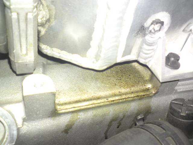

Old Nov 7, 2009 | 12:22 PM
Driv3r's Avatar
Driv3r
Joined: Sep 2009
Posts: 123
this is what it looks like? am i referring to the right thing? Boost leak? Loss of power because of this? will have it fixed soon

Old Nov 8, 2009 | 07:42 AM
ZippyNH's Avatar
ZippyNH
Joined: Sep 2009
Posts: 12,605
Likes: 41
From: Southern NH
It is tough to tell from the picture....it seems to be in the right location...if the oil is slick...then it is fresh. If it is sticky and tackey....it might be from an older scource.....if it is very thick and sticky, look carefully around your upper motor mount....they are filled with a thick viscous oil that tends to leak as the mount fails.
Like I said, if it is a leak caused by a pintched or leaky intercooler boot, it is so easy to fix it would be a shame to not DIY it. 4 torix srews to remove an intercooler cover, then 4 torix screws on each pair of boots....and you my have to remove the lower mounting clips/bolts that holds it in place...2 bolts, very obvious and easy. A torx bolt/screw is just a special head on a screwdriver, commonly avalable, and pretty cheap.
I would fix it soon, mostly cause it is easy to do, cheap and a good way to have some quality time with your car.
Old Nov 8, 2009 | 03:36 PM
ElPolloDiablo's Avatar
ElPolloDiablo
Joined: May 2007
Posts: 37
From: Denver CO
If you look closely up around the intake on the intercooler, it looks like there's some oil residue there. . .probably where it's coming from.
I had this issue on my car. . .One of the clamps had stripped out and it was losing boost over 8psi. But your clamp looks tight. . .I would definitely take a look at the boot.
