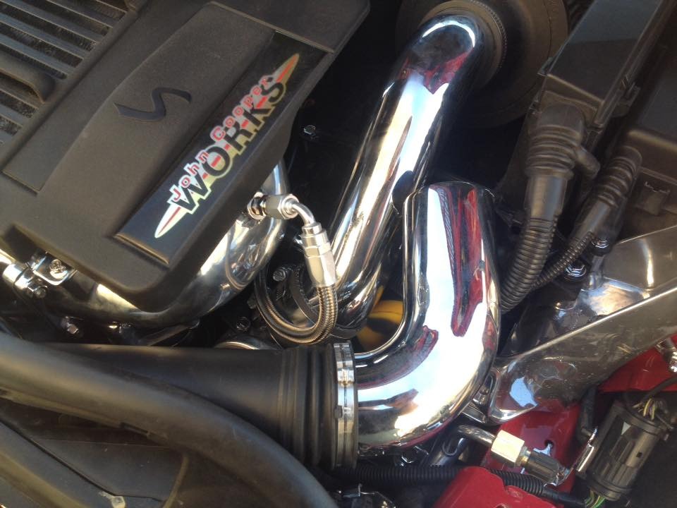

I inject my meth right here:

yeah just like that, typically the horn post IC. some have injected pre charger as well

Nice! So, hey, does that jc works intercooler shroud really help? Or is there a different intercooler under it too? Ive seen aftermarket shrouds that claim improvements of airflow.

JCW shroud is the same as the S, just branded different. GP had the larger intercooler and shroud. I have the alta diverter, seems like it helps when I compare to everyone else IATs, but only marginally. a 3-5 deg difference typically, which equates to about .5% hp or less. which gives you less than 1hp and being $130.... about $150 per hp
The JCW ones are the same as OEM, but they have that sticker. The one I have in the pic is a GP intercooler and cover, same as OEM, but it has two more rows and is really the best one for these cars. Pretty sure some of the aftermarket diverters were tested as being better than the OEM cover, but I can't remember which ones were the best since I've had the GP for so long and there weren't really any offered for it at the time. If your going to spray meth, you'll get far more cooling from that than any intercooler or diverter though.

Are your meth sprayers constant feed or rpm specific via pedal switch?

I have an Aquamist HFS-3 system which is one of the best kits out there. Most people go with Devil's Own, Coolingmist, Snow's, or AEM, because they're cheap, but Aquamist is not even in the same class as those. It's controller taps into the fuel injectors and runs off the injector duty cycle. It also has a fast acting valve that sprays variably with pulse width modulation like a fuel injector. The controller on it allows you to control every aspect and it even has fail-safes that you customize so it won't pop your motor if it runs out. You can check it out here:
http://howertonengineering.com/mini/

Great system...if you don't buy it you will wish you did....
And NEVER USE BLUE WASHER FLUID....EXCEPT to get home if you run out...
It is almost always made with hard water (look at the blue spots it leaves when it dries) and has other added ingredients.... The minerals will crystalize and Basicly TEAR UP YOUR MOTOR LIKE SANDPAPER....end result...low compression...much worse than running with no airfilters...
Some folks on Facebook/LXM talk about doing it..don't. It is a way to kill your car about as fast as pouring SAND, AKA MINERALS into your air intake, post filter....
And anytime I hear a person claim washer fluid is made with distilled water...let's just say they have been brainwashed by reading bad info again and again....
That having been said, DAVE-O, (philly area) banned on a few MINI sites has a 250+ HP daily driver, and has been very reliable...heck even has the stock cat welded to a RMW shorty header if I recall right, so no codes.....
While meth/water provides decent COOLING, running 100% or near 100% METH adds not only COOLING, but adds extra octane, fuel, and keeps your motors very clean.....
If I had to do it again, I would do meth on my MINI...total amount used in a daily driver tends to be small.....most report a couple gallons a month, depending on how it is setup.
