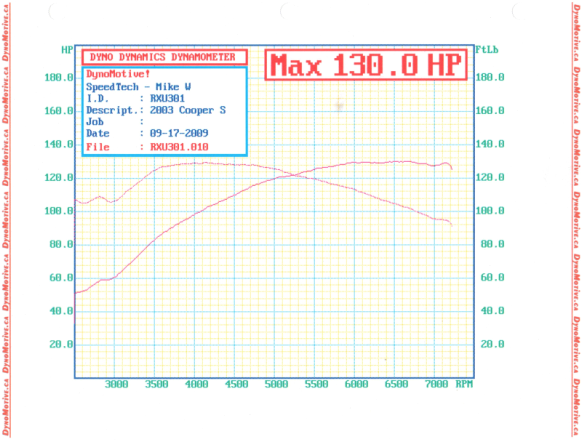

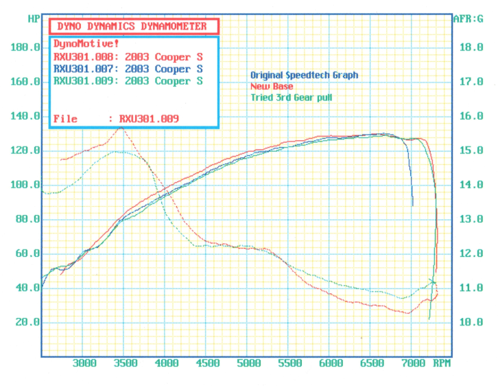

Hey guys, so I'm kinda surprised at these dyno results... mods on my car are: 15% pulley, Alta CAI, RMW header, RMW tune, and 2.5" ALTA catback. Can anyone tell me HOW my results are lower than stock after these mods? And also, what would be the next greatest mod for boosting power (apart from a new head)? Thanks!

What is your before and after? Do you live in a high altitude area?

well, before the header and tune, on the same dyno i ran exactly 130whp. So apparently I gained nothing from the header and tune

My guess is the dyno isn't calibrated correctly? Isn't it pretty impossible to run two exact numbers on two different days? I thought the graphs people posted of their dynos was the highest reading of 3 pulls.

What are other MINIs making on this dyno? or some reference number to other cars b/c dyno numbers by themselves don't mean a whole lot. DD are lower-reading dyno's b/c they put a load on the vehicle similar to the Mustang Dyno's...
Nonetheless, 130 seems really low... especially with all your added parts, at least there should be some kind of 'delta'...

i think that maybe the dyno wasnt calibrated

1) did your butt dyno tell you these mods added any power.... ?
2) If so, this dyno test was a bust, go somplace else for a second opinion before doing any more mods, then go back to the guy from this test and get your money back.....

It definately does feel faster but I still cant beat my friends IS 250 (204hp, soo about 164whp) and hes 800lbs heavier, leading me to think this dyno MIGHT be correct??? reading everyone elses charts I should be at like 190+whp...

so what are other cars putting down on this dyno? that would give a better idea of what the dyno is reading.

well, i saw an 135i with the M package put down 319whp and a 335i at 309whp..

Something must be wrong with the dyno, if the car was that far off Jan would have known it then.... Is the car running the same to your butt dyno now as it was when Jan finished?

Those numbers are consistent so we know the dyno is reading right. My stock 335i did 270whp on a Mustang Dyno in AZ so those are realistic number....
