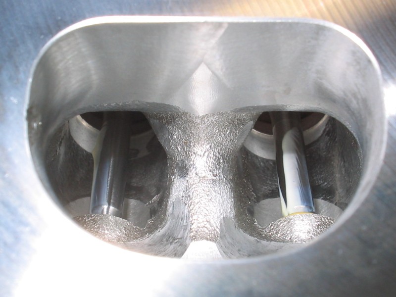

Bullsh.it! The S exhaust valves are made from inconel, the cooper valves are simple valve steelt.
The shaft diameter is only 6,x mm much to lees for sodium filling.

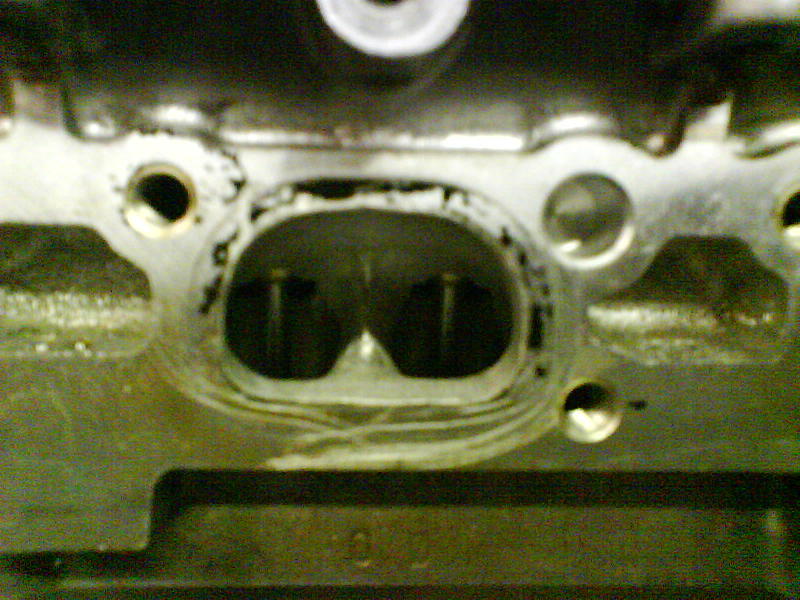

The JCW head is cnc ported on the exhaust side, nothing else.
Here are some pics....
Attached Thumbnails 02-06 JCW cyl head vs. MCS head-dsc00076.jpg   02-06 JCW cyl head vs. MCS head-tooling-1.jpg   02-06 JCW cyl head vs. MCS head-tooling-3.jpg

I guess the first pic is from an S head and the other 2 are from the JCW, right?

Yes the first pic is a standard cooper S head, the other two details about the JCW porting.
That's right!
