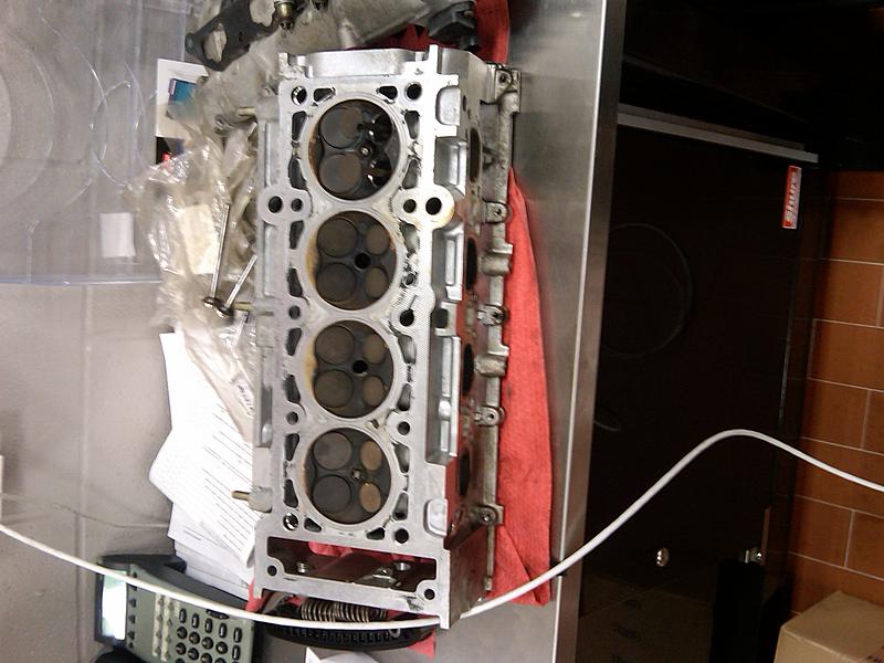

Visual Inspection
Guys,
Here are the results of my visual inspection:
1 broken valve in cyl. # 4, the other valve seems to be bent.
Also, the valves for cyl. 1 seem to be bent as well.
The cylinder walls do not have visual damage (no cracks, seams, tears, or others).
Pistons have no visual damage either.
Mechanic indicated that a compression and leak down test will be performed after the head would be installed to confirmed there is no problems with either the head, block or components.
See attached photos.

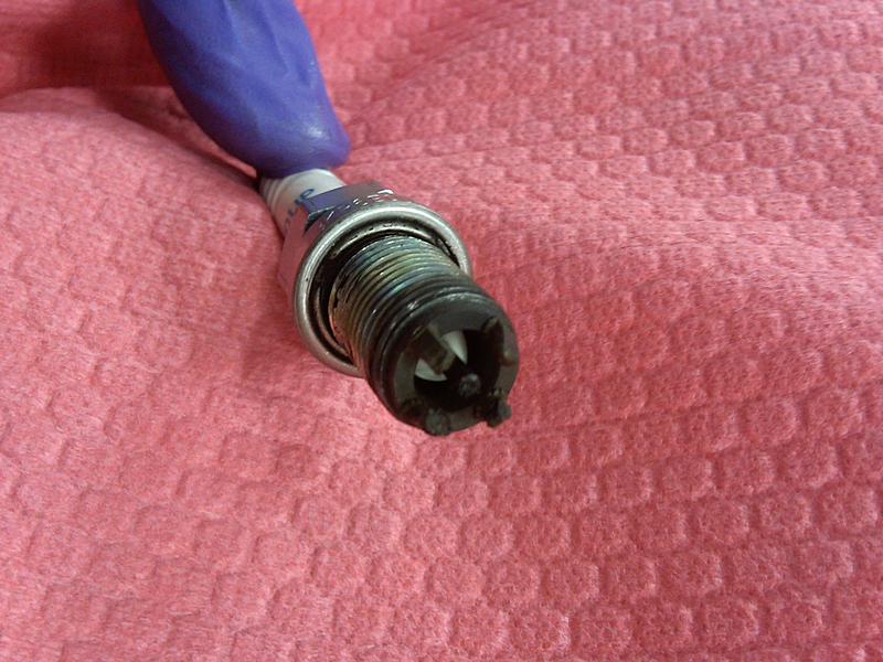

See more photos below showing SP's broken ceramic tip, cylinder walls and piston heads.[

I'm no expert but those pics of the valve kinda look like it might have been melted. Had something similar happen to a mustang of mine a few years back, the spark plug failed and was arcing across to the valve which caused the valve to melt. Again I'm no expert, but I'm just throwing it out there as a possiblity.

MELTED!! Man that isnt broken... that is MELTED!!! No spark plug electrode did that.. the heat was so high in that chamber that you "Burned the valve"!! Need to find out WHY that happened.. as that is the result of something else!! too lean?? Too much boost?? I would suggest that if the rings are still good, a water meth system will help . Make sure the shop keeps those rings with oil in the cylinders!! cool??
Just me........................
Thumper
WAIT!! No 4?? that cylinder has an issue with the intake manifold starving the chamber for fuel!! Number 4 is the most often of all the head/cylinder issues!!
Tpr
PPS... looking at the pics of your engine... get some oil on it!! In the cylinders or you WILL need a set of rings and rebuild after all that rust!!!!!

Yea, looks like a melted valve, but pics are somewhat unclear.
Could be the tune, could be a bad injector.
Have that injector checked now. Make sure you have someone who knows what they are doing to check it as you just don't want someone to assume that its bad.
This is one reason that those who are getting these 'on the edge' tunes need to have the right equipment in their cars to read what's going on. Either a good data acquisition system or a wide band O2 and without a doubt, an EGT sensor with gages of course.
Thumper
Tpr
That's #1 cylinder that's burned I believe. And yes, #4 is usually the problem
Not sure he wil need rings and rebuild. Not so much rust.
Edit, ... well maybe there is too much rust. Whats up with the mechanic here??

sorry, I was mistaken. That was #4 that was missing it's valves.
Now, after I looked very close at the head I could now see that bothe #1 and #4 were way lean.All of this and I never read cucho's mechanic report until now.
Bad tune man! That's really what it looks like. Post # 26 and #35..... what can you say. Someone fried your head.

Yeah, you are right...it was melted. And yes, I am disappointed that the mechanic has let the block rust like that .
Things to do:
- Have the mechanic remove that rust and put some oil on the block
- Inspect injectors from cyl 1 and 4 to see if they are faulty..running lean, if they are ok, then the root cause of this issue has been something else.
Thanks for the input
