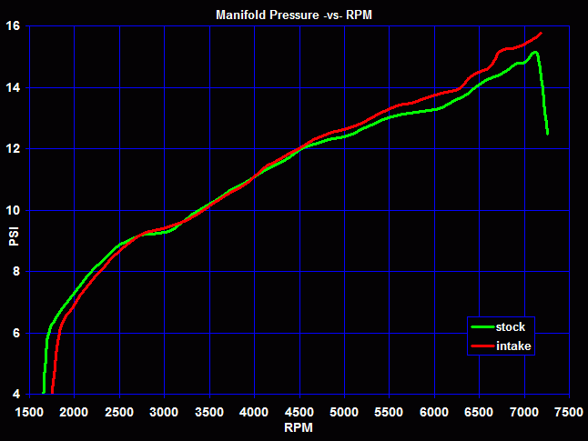

>>I have seen that, but that doesn't address the question of how much of the gain the Shark is actually responsible for. In fact, that chart doesn't indicate which runs (if any) had the Shark installed.
>>Added to that, I am EXTREMELY skeptical of any dyno charts showing signifcant low-end torque gains from intakes. Here's what my boost curves look like with the stock airbox compared to the Alta intake:
>>Note how the curves are almost identical to 4500 rpm.
>>_________________
>>1/4 Mile Database
Andy,
I totaly agree there, you should see the most improvements from a free flow air filter at the top of the curve where the stock filter begins to fall off because of airflow restriction. Low end torque and High end "FWHP" are always a trade off.
The Dyno chart from Turner is Stock, Pulley/Shark, Pulley/Shark/Intake. Turner doesn't install pulley's without the ECU because they say it run's too lean without it.

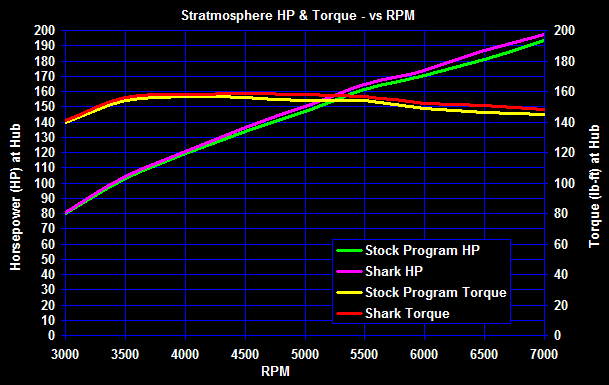

Here's the higher of the two stock pulls compared with the shark pull, in a little more easily viewable format:

Damn! You need a job?

If I am reading them correctly, it looks like 8.5 horses and only 2 lbs of torque. And the torque doesn't really seperate from stock until approaching 5k RPMs.

The torque also hits ealier and stays later as well. Plus, don't forget that the Fuel-Air is now corrected to run less lean (more lean would = even more power) -Pete, Strat
