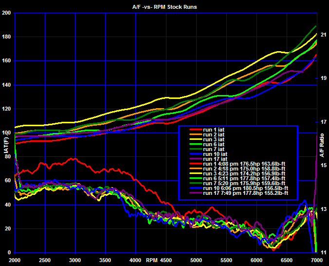

As far as Octane goes, I believe the ECM will adjust for what it sees in terms of spark advance, etc.
AFR (Air fuel ratio). Without posting a chart...
Stock- 2000rpm 13 AFR, 3000-12.7, 4000-12.1, 5000-11.3, 6000-11.1, dip to 10.9 at 6150.
SHARKED- 2000rpm 12.1 AFR, 3000-12.05, 4000-11.45, 5000-10.95, 6000-10.7, dip to 10.6 at 6,100.

I don't get why the shark makes the mixture RICHER. Something is wrong with those numbers because all the numbers I've seen have the S with much richer air/fuel mixtures. And if you make them richer on top of that, well I just don't get it.
>>Run with stock (no Shark). 155.6ft/lb with a peak at 4,384. 188.9hp at 6,890.
>>With Shark. 202.3hp at 6,937. 159.3ft/lb with 4,485 peak but the torque is earlier and separates from stock at 2,900 rpm with a good deal of area over the stock torque curve through 5,000 and then much more from there to redline. Shark torque is flatter, stock is peaky.
>>Very important. Car ran at least .5 AFR lower with the Shark (more rich). Some stock pulls just looked too lean to us.
Only 3.5lbs in peak torque? And an increase in richness? I'm confused. I know the torque curve is fattened but it can't be by that much if the peak is only 3.5lbs. The GIAC chip should give well more than twice that and I hear the torque curve is REALLY FAT!
Still very confused about making the mixture richer...
