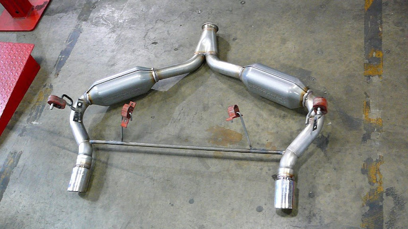

Here's a commercial split system - blueflame. It comes with a rear clip on valence so will work with OEM bumper but I ended up getting a Cooper non s aero bumper and custom cutouts to improve the aesthetics.

That ^ rocks.
