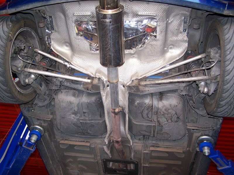

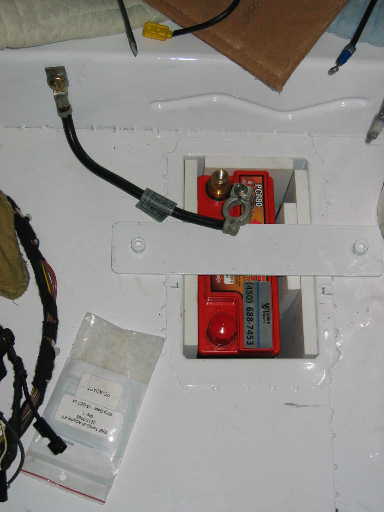

Here is an average removal of a battery box. I used a spot weld cutter to drop out the box and then riveted in an aluminum plate and mounted a new 11.5 pound battery on top. Works great. Not to loud using a Super Sprint center pipe with resonator and a Borla turbo muffler.
How is the ground clearance with the borla muffler vertical like that?
That seems like the best solution. I assume borla makes that muffler with intentions of keeping the straight turbo system quiet. Plus there is a supersprint centerpipe and resonator on ebay right now going for CHEAP that I may have to snag...
The ground clearance is not an issue. The muffler I used (40659) has an offset/center inlet and outlet. I use the offset for the inlet and the center as the exit. This is due to the need for about a 2.5 inch elevation gain needed to keep the tip level when it exits.

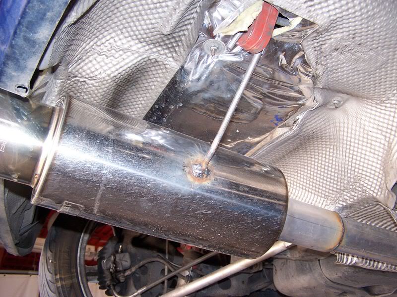

Here are some pics of my recently finished straight through exhaust. Used the bottom of the battery box to patch the hole. Then used some Cool It mat form ThermoTec for insulation, with RTV to seal the seam after welding.
