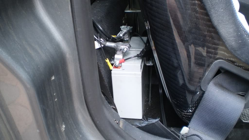

In preparation for the install of our rear tunnel diffusers I have slowly been changing the car for a straight exhaust system . The battery relocation issue was the first up and this is how I solved it . I have mounted a 14lb battery behind the passenger seat on the floor . I made a mount out of flat aluminum and bent up a hold down strap and together with some simple threaded rod secured it to the mount plate which is in turn held down by the rear two seat bolts. I used a set of 4ft battery cables and added them to the stock end pieces, ran them under the rear seat delete and to the new location . As my car is more of a weekend warier now I was concerned with the lightweight batter going dead during the week of sitting so I went to Pep Boys and picked up a battery " conditioner " for about $ 30. It comes with a harness which you permanently mount to the battery terminals . When I get home I simply connect the harness to the cable coming from the wall plug and leave it until I drive the car again . Works like a champ so far.

Go back to Pep Boys and get some battery terminal covers. Not a good idea to have the terminals open like that w/o something covering them. Most track organizations won't let you run with exposed terminals like that. Some also require that the battery be attached using 4 points.
Old Nov 3, 2008 | 11:07 AM
  #62
maxmini's Avatar
maxmini
Joined: Jul 2002
Posts: 3,446
Likes: 10
From: L.A ca
These Photos were taken during the initial install process but it is good that you brought this point up for others seeing these snap shots .

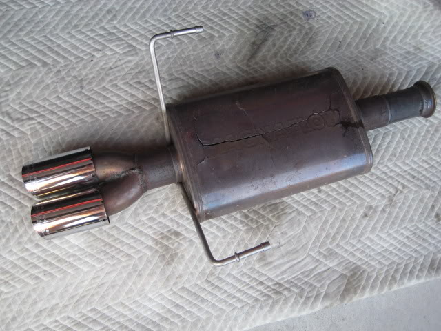

Originally Posted by Longboard Mini
I have a modified Magnaflow (new vestion) cat back. It uses a round muffler on the center pipe right before the split. I've killed three . ...The other people to check out is Stainless Works. They make mufflers that will out last your car and never burn out.
Longboard
Did it look anything like this?
