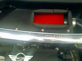

Well i installed the ddmworks intake i am wright now having alot of problems running rich and engine light is on bummer of course i also have the alta turbo hoses. this is going to b hard to fix i have ddmworks and mini looking into the problem any feed back?
Well whenever you make any changes to the car, we can only assume they are directly related to them. If you put the boost tubes and intake on at the same time lets assume something is amiss there. Can you answer that for sure first? Give us some details and we can go further with a solution! I am willing to help in anyway I can!
adam@altaminiperformance.com
DO THIS FIRST!!!! Check the connections on the inlet tubes (everywhere) From what you describe you have a small vacuum / boost leak. That throws the ECU into fits. IF THE PROBLEM ONLY CAME AFTER THE JCW FLASH: Then go back to the dealer. Hope that helps!
