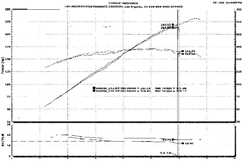

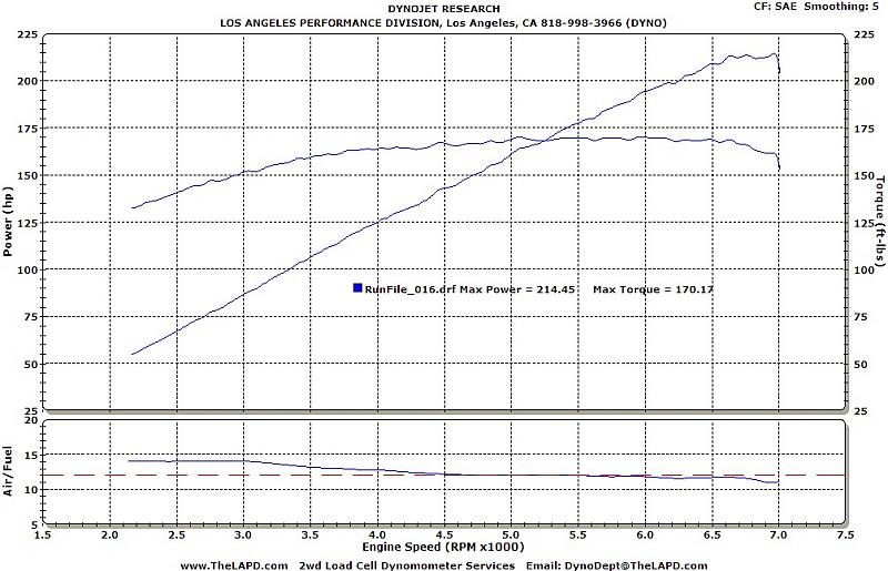

I went to the dyno today and got a run with a stock flash from MINI to clear up confusion. This is at stock redline so at 6800rpm the tuned car make 218.52 and hte stock flash made 214.09 max torque was 171.88 on the tuned car and 170.17 on the stock flashed car.
Attached Thumbnails Revolution Mini Works car breaks 251.72whp-dannys-2004-stock-flash.jpg   Revolution Mini Works car breaks 251.72whp-danny-dyno1.jpg

I'm glad to know I still hold the record for the highest WHP with the stock ECU at the stock red line. Thats for you Danny.
All joking aside, with the tune it only picked up 4hp at the stock red line. The tuned TQ was basically the same as stock .
So it sounds like the big number are from something other then the tune.

Now to the car, you haven't changed anything on the car bar having the standard ecu map put back in the car.
If this is so why is Longboards so much better??has you car got an old style blower fitted??
Thanks for sharing the info with us Danny, makes the extra 36whp you had before even more impressive.

We took off the parts that made the last 20hp then reflashed the car to stock. The delta of stock map to the tune with stock rev limit is a apples to apples comparisons was 4hp and 1ft lb of torque.
My car has different parts on it compared to longboards. Bigger exhaust a cam and different collector made for high rpm power. It made most of its power in the last few thousand rpms

Good point...I'm seeing hardware making all the difference here rather than software in this case...

Why wouldn't he post that? It shows the parts made the power.... All you had to do with the proper parts is turn up the redline to get more. It took him to 7800 rpm to make the 232 and 235whp runs with different pullies.
Notice the big difference under the curve, the car is MUCH MORE RESPONSIVE and the tq is much higher up to 5k rpms. Once we get the rev limit raised we will be going back over 250 again.
The car is running 2 a/fs better now and the EGTs are almost 200 deg cooler. We did some testing yesterday in 107 degree heat in the Valley and are very pleased with the results. The car is adapting better to the stock map and I think you will see even higher numbers shortly.

So the mystery part/parts and rev limiter moved to 8k is worth 32whp

actually it will be worth more than that with the PROPER tune
it was between 102 -107 degrees yesterday when we were dynoing
