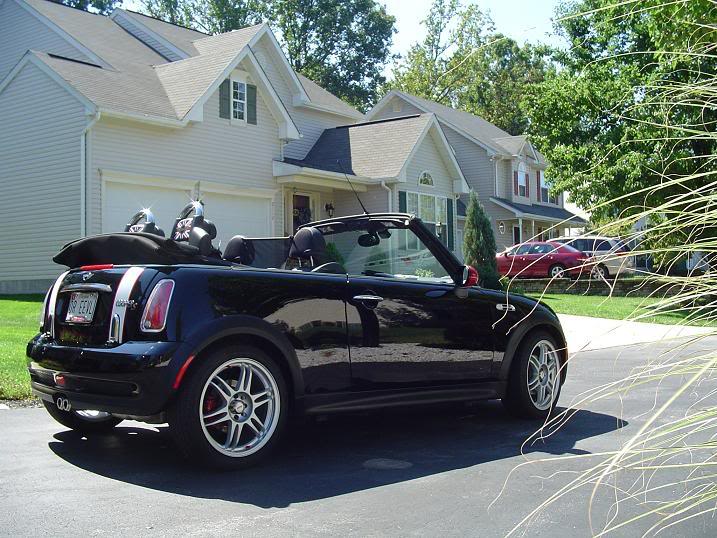

Here's my Jet Black MCSC after a detailing with the random orbital buffer and a series of Prima brand polishes and wax:

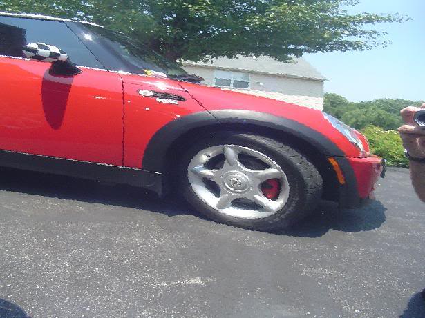

Yeah, that's the door of my Jet Black MINI with my CR R50's reflection in it. Here's another shot taken that same day:
Your roof is the same color. You can make it look like that.
