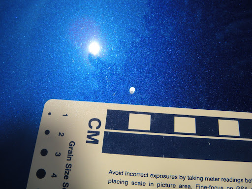

Here's a bad one:

i would use a toothpick with tip tapped on a table or something
to make it flat as your applicator.
mix your clearcoat and basecoat 50/50 so that you dont
need to do a final coat.
i dont use langka and im not too picky about chips so
i apply, let dry 4-5hrs. reapply, let dry 4-5hrs.
and depending on how deep it is (is not) reapply and
let dry for one week. then i pull out my 2000grit
sanding block and wet sand it down to match the
height of the surrouding paint.
then let it be for another week, then polish/wax.
if you rush to do your polish/wax your touchup will
also come off.
