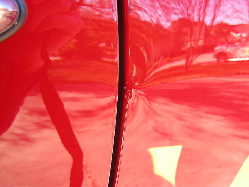

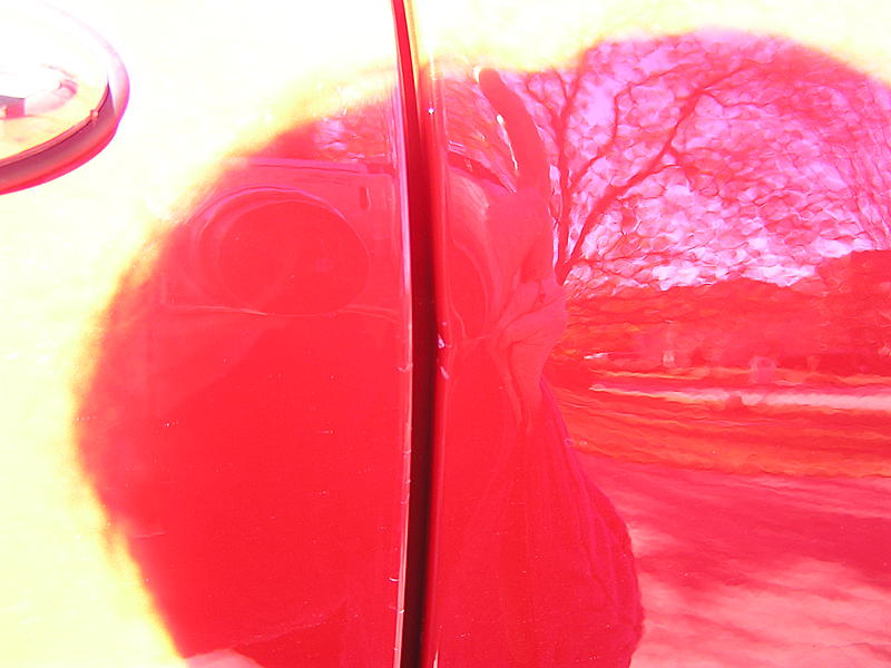

Dent--can anyone figure out how this happened?
I came out of the PO the other day and noticed this dent. I'd never noticed it before, and neither had my husband--both of us wash the car. I still can't figure out how it can be RAISED on one side, and non-existent on the door side. There are a couple of small paint chips, too. It almost looks as if someone closed the door on a seatbelt, except that no one did, and the belt loopie is fastened so the buckle is higher than this.
At any rate, can it be fixed without replacing the car? Have any of you used a dent doctor for this kind of ding?

Seat belt buckle get slammed in there?

Somebody tried to break in to your car by prying it open.... You can talk to Dent Wizard (and I would) but me thinks you will need a good body shop to fix it right...

Yep, this is not a dent. It does seem like the door was slammed and hit an obstacle. A dent repair shop will not be able to fix it as the paint was broken and the damage is a bit creased. It can be fixed, but I would recommend a good body shop.

Judging by the convergence in the reflection it appears to be a singular impact. Like others have said, PDR won't likely be the solution. In this case, PDR (Paintless Dent Removal) isn't limited by whether there is paint loss or not--although that would determine the success of the repair--but on where this impact is. It's very difficult to push back or reform an edge using PDR techniques. I'm not a PDR expert though--maybe Kenchan can chime in here.

yep, as OG mentioned above, something got sandwitched when you
closed the door. that's a dent impact from the left side moving towards
the right. nearly impossible to fix completely with just PDR. that high
spot is too close to the edge and reinforced itself. your door is slightly
bent too.
body shop will probably take a knockdown tool with hammer and smack
it down, spot bondo, sand, and repaint.

A seat belt incident is, of course a logical thought, but neither I nor my husband has had one--only 2 possiblities. Unless...it was done at the dealer when I had it in for a couple of minor things last month. Hmmm. Sh^#. I'll bet that was it. I don't think either of us washed it right after that, and thus might not have seen it.
Sure would have been nice to see it back then...
