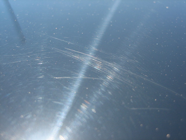

I've never owned even a halfway decent car before, and now I've got a new MINI and want it to stay looking Very Nice, but have no experience whatsoever. I've been lurking on this forum the last few days, and I think I've got the basics down.
Unfortunately, after my first washing regimen, I noticed some little scratched areas in a couple places on the black roof (not swirled, but straight). I really don't know if they were there before, or if I somehow made them with the microfiber mitt when gently rubbing its well-shampooed self over the pre-rinsed paint.
So would y'all kindly let me know your opinions on possible sources, and also possible solutions (I assume I'll need to buff it out -- is there a decent over-the-counter product someone could recommend?), according to the picture below?
I've got some swirls and specks, too, but ignore those -- I think I'm getting the hang of dealing with them (biggest mistake was thinking I could wash at night by porchlight -- sure, it was cooler, but I couldn't see worth beans to tell where water was spottily gathering. I especially shouldn't have misted with the wax-as-you-dry solution until I'd gotten the hang of washing without spots and streaks, because now those spots and streaks are semi-permanentized by wax)
It looks kind of bad, like the black paint is actually scratched, but that seems unlikely... when the clearcoat is scratched on a black surface, is that the impression it usually gives? Thanks for letting me benefit from your accumulated wisdom and experience.

I can't tell for sure but that looks to be surface scratches and pretty light ones- try Mequiars Scratch X, follow the directions on the tube but overall it's pretty easy to use. If that does not work you might have to get it buffed out but it doesn't look that deep to me but it's hard to tell from a photo.
You can do the finger nail test. If you can catch them with your finger nail then chances are you will need more help than ScratchX can provide. I'm assuming you don't have a PC to help you. If not then ScratchX on a firm foam pad or a DP blue pad is the way to go. You will need to put some effort into it and it will take more than one application. I can not tell from the picture what or when these were caused.
As for spotted spray-on wax; you should never allow spray-on wax to actually dry on the paint. I understand you could not see. Try spraying the dried spots with more of the spray on wax. That should remove them. If not, time for either clay or more ScratchX.

I bet you're right, chows, that they're scratches from dirt on a towel. I should have washed all the towels and so forth that I bought before using them.
MDK -- yeah, I suppose they're probably not that bad. My perspective is still a little tweaked due to new-new-car-owner-obsessia.
Looking at them again, they really do look pretty shallow. (Sorry I couldn't get a better picture -- that's the best I could manage)
Maybe -- your fingernail test confirms it. I can't feel them at all.
I'll go grab some ScratchX and see if I can't persuade those suckers away.
There are some others kind of in that general area, then a few more on the bar running down from the roof on the other side of the car, but none anywhere else that I can see. I am feeling slightly paranoid wondering what it was that caused them, but I'll go with the dirt in a towel theory for now. I would prefer to dry without any rubbing to avoid just that, but I'm also quite enamored of the idea of hydro/spray-on-as-you-dry wax, which requires at least a little gentle rubbing while drying, doesn't it?
So the way to fix wax spots is more wax, eh? Go figure. I'll try that, too.

The scratches were definitely superficial -- It was hard to even find them in the shade, as noticeable as they were in direct sun. The ScratchX took 'em right out. I'll be careful what I use in the future to dry. Thanks for the advice.

All scratches are hard to see in the shade.
Based on your supplied image, this is what I see
All of them except for maybe the holograms should be removable via ScratchX--you understand that this is not a product you just apply and wipe off--you apply it and rub like mad until the white cream turns clear. And you repeat this process--your MINI should be rocking as you do this, your fingers should be pretty sore, and you should be sweating after the 5th application or so.
(I know you already used ScratchX and found satisfaction--just wanted to clarify the process)
A PC should remove all of this pretty easily, otherwise Hydro will improve the appearance by masking them.
Glad you found success in your efforts.

OctaneGuy - now that is a wickedly cool visual analysis. I'm okay with not being able to do away the hologram. I think the occasional hologram adds something to any feast for the eyes.
Yep, I had to really rub the infernal things hard for a long time (wore me out) to get results with ScratchX, but it definitely had an effect. Of course, even now the scratches are still sort of there if you look just right in the full sun, but they're inconspicuous enough for the time being. Especially since I am now noticing all sorts of scratches that aren't quite as pronounced as those first ones, but that are still visible. I really do wonder whence they came. And some have definitely appeared without me touching the area in question. I guess that's just going to happen sometimes, and that's why you wax, eh?
The swirls were most assuredly not my doing, either. They're too even, too prevalent, and too present in areas where I know I didn't use a swirling motion for anything. I don't get how a dealer would think it's a good idea to do something to your car that regularly results in such an effect. Ah well.

Lucky for you that you can accept holograms on your Mini's finish.
Although you'll most likely need to put the rotary to work here, if you're satifisfied with them and happy then we're all happy with and for you.
Keep learning and keep practicing and you should be fine in no time.

Do you garage your car nightly?
Is it a daily driver?
Where is it parked when you're at work?
How often and what do you use to wash it? The two bucket system?
Your paint may be scratch sensitive and you should really look into investing in some quality microfibre towels to remove wax.
In terms of your other scratches, the problem I find is when you maintain your car to highest possible standards, you notice more. For example, I just detailed what was suppose to be a Jet Black Honda Accord, and when all done and said, it turned out that its original colour is actually Nighthawk will blue metallic flakes. Point: the cleaner the car the more you notice.
Some Mini's that I've worked on seem to be scratch sensitive so you need to be really careful.
Personally if I were you, and if you have the time and are willing, I'd do a full detail and eliminate the swirls/scratches at once and then just maintain it to your highest possible ability as opposed to tackling scratches here and there. Know what I mean?
Ah, the work of a dealer detailer. Don't get me wrong, some out there might be good, while others are going to be horrible and I've had my run in with the latter of the two. Its unfortunate. No real answer as to why. Its the same as to why they hire 'detailers' and pay them $10/hour. Do you think those 'kids' (my experience) care about your car. I've seen them drop their towels pick them up and keep working on the car. That'll put scartches in for sure. And I've seen plenty of cars with holograms instilled from their detailer at the lot.
Once you got your swirls all elimanted it'll be best to try and figure out where they are coming from and stop them at the root of the problem. Get yourself some quality towels and some water magnets to dry your car and begin using two buckets to wash your car and you'll be on your way. One of the biggest problem areas is the washing. I've seen people and heard stories washing their tires with those big brushes attached to a broom handle and then move straight to the roof and the rest of the car. Swirl city here I come.
Hope that helps.
