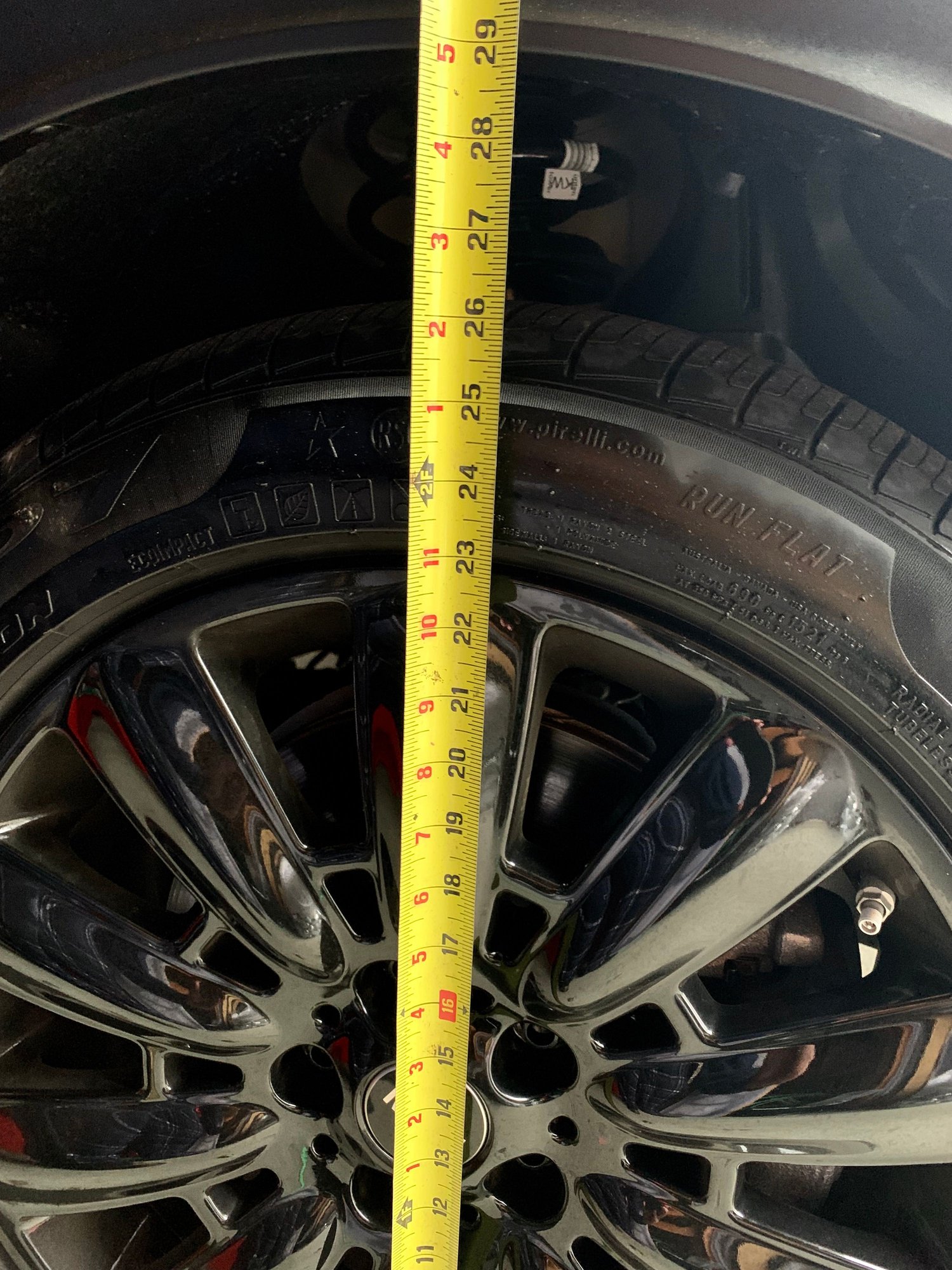

Help me fit a tire
I have a 2019 CMS and it came with 225 50 18 and there’s a world of gap I’m trying to fill. I think as far as the height goes it’s as simple as measuring the height you have to see what fits. Im guessing it’s the aftermarket wheel offset et35 or 45 etc that pushes the wheels out or in that affects rubbing but if you stick with the 45 you can adjust with spacers. I think. I would love someone to post the biggest tire and offset that could be used. Now according to one member he has an R60 he has stock et with biggest dimension of 28 inch on stock suspension and wheels. I’m looking at an 18x8 et40 wheel.

That’s true. My current stock tire is 225 50 18. Which is 26.9 high and you see the gap I have. I was looking at a 235 55 which is 28.2 high or I can go with 230 55 which is 28 high and matches the thread below. So I don’t see a problem.

My new rims are 18x8 et40 My stock 225 50 18 are 8.9 wide have room. I want to go with a wider tires.Im looking at a 255 45 18 which is 10 inches wide same height and is pushed out more than the stock. I have never seen anyone running a 255 but it says it will work?
