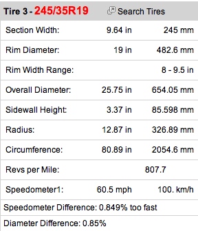

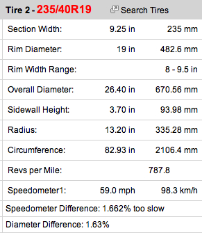

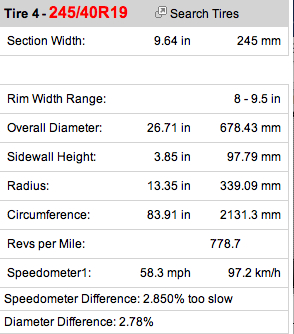

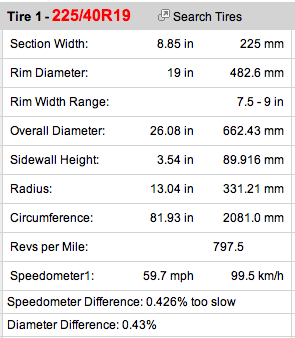

The bigger question is size. I am leaning towards 245/40/19 based on MotoGreg's setup, which looks killer.
Attached (across two posts) are charts showing different tire/wheel combinations and their effect on overall diameter, etc.
As you can see, 245/40/19 is a little taller and wider than the 225/45/18 on the stock setup. I figure that the significantly decreased weight will more than make up for any loss in acceleration and torque.
235/40/19 is probably out because it seems there are so few tire choices available in that size.
225/40/19 and 245/35/19 are very close to each other in overall diameter and are very close to stock; both are less than 1% off. 245/35/19 produces a very short sidewall (3.37"), however, and that might increase the odds of damage to the rims as well as make the ride more harsh.
I am really not sure what to do with tire size and would appreciate some input from the board.

Thanks for the posts, everyone. I really appreciate the feedback. Size-wise, it looks like got at least two votes for 245/40/19 (Bakerbirdz and MotoGreg).
It looks like there is a slight tendency for the NM wheels if cost is taken out of the equation. (For what it's worth, my old lady loved the NM wheels . . . until she saw the price tag, then asked, "How much are the other ones again . . . ?"
If NMs were 50% more than the Elbrus wheels, it would be hard not to go with the NMs. But 100% more is tough to swallow. For what it's worth, I found them for 10% cheaper from a different website: http://www.customcarscentral.com/neu...w#.T9wRk475ERU
