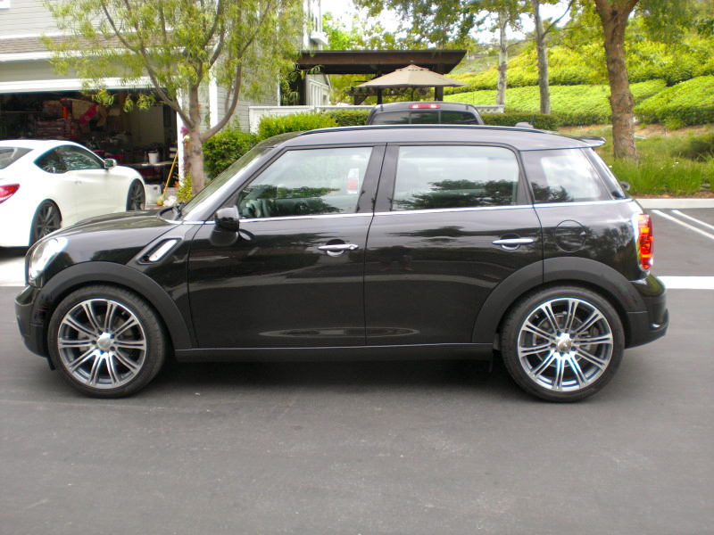

there is someone on here that has a lowered R60 with NM springs and +35 wheels and he has no probs! He even is running 245/40/19!! Its the route Im going as well!!
That may be me, I haven't seen anyone else post on here with 245 tires besides me yet. For the record, mine are 19x8.5+42.
Now if I could just get it down another inch or so, to look more like the white car in the background...

are you lowered on NM springs?
Yes
It wouldn't have any effect on the suspension components....Only risk is rubbing
Geez, we keep going round and round in circles here. There are quite a few of us now who have 19x8.5 and are lowered, and all of us have said there is no problem, no rubbing, and we're all happy with the results. Actual real life, real world feedback... not speculation. No risk, only tested and proven results.
Here is jbcola's car (photo below borrowed from the "show us your summer wheels" thread) - he has 19.8.5+38, so they stick out 4mm further than mine. Plus he has Cobra springs which put the car even lower than my NM springs... he probably has the most aggressive fit we've seen yet on an R60, and it still doesn't rub. Seriously, there is no need for you guys to keep speculating and worrying, the sizes and fitment have been proven.

Great minds think alike, Greg! I agree wholeheartedly with every point you make. They are like the Interlagos but better: 10 spokes instead of 9; an "edged," tapered spoke; and a cool lug/spoke intersection. The size is right, the offset seems right, and the weight is right. Plus, I kind of dig the they are designed specifically for BMWs, given that Minis are part of the BMW family tree.
I really think these are the wheels I am going to buy.
They make BMW wheels, and BMWs all have the same centerbore as the R60. So it's safe to say they bolt straight on with no rings needed. They probably just rounded off the 72.56 to 72.
I was hoping that was the case. So we are reasonably confident, then, that these should slip on with no issue?
For the record though, just because you asked, yes, you can have the CB of a wheel machined larger. I used to have an Acura Legend and I put some wheels from another Honda on it. Their CB was slightly smaller and I had a local shop machine them larger for $25 per wheel.
Good to know. I was nervous that machining might create micro fractures that would eventually crack at, say, the well for the lug bolts. But if it is regularly done without issue, that makes me feel a lot better. (Though, again, it sounds like it won't be necessary.)
I like the black, but in this silver one you can really see the details good. Also, funny thing, I copied the image URL to post this pic below, and noticed it's at tsw.com and since these are "rotary forged" I'm thinking TSW makes these for Beyern.
That is the downside of black wheels, is that they "hide" the details of the wheel itself. Still, with my car blacked out like it is, there is simply no way I can go with silver/chrome. Got to stay sinister and mean.
And you are right about the TSW connection. I actually stumbled across the Beyern wheels while poking around on TSW's website. It seemed to be too good to be true.
So I guess this wheel is it, right?

I would go for it. They seem to have it all; great looks, lightweight, the perfect size, and they're really inexpensive for a lightweight, forged wheel. You might be the first, but I have a feeling a lot of R60 owners are going to be copying you with these.
Most of the aftermarket BMW wheels take the standard BMW size centercap, and I assume these do as well. On ours, I didn't like the plain chrome caps that came with the wheels, and I didn't want BMW logo center caps on a MINI. I put on a cheap (less than $20 for the set if I remember right) set of BMW M-power center caps for now, but I'm not really crazy about the look. These Beyern ones look a lot better. I may swap ours out to Alpina, AC Schnitzer, or something else like that.

would be a problem of rubbing if I install 19x8.5 +40 with 245/40/19 tires? I'm also thinking to lower it at least 1.2" if the NM springs allows it(if there is a 1.2" lowering springs, i mean).
No problem. That is is the same setup I have, just 2mm difference on the offset.
Yep. My mind is made up and I'm going to pull the trigger on them. I have you to thank, MotoGreg, as I really never would have considered or found a wheel like that if you hadn't opened me up to the 9- or 10-spoke wheel option. I really appreciate your help (and patience) with this process. I will, of course, post up some pics when they arrive.
Yeah, I am not sure I like the obviously BMW-esque Beyern blue and white center cap. Maybe I will put some decals over them like these:
http://www.ebay.com/itm/Mini-Cooper-...#ht_606wt_1041
So what's next? Would you recommend ordering the tires from, say, TireRack and having them sent to a Discount Tire, then taking the wheels to Discount Tire and getting them mounted?
What about springs? I am going to be putting on the NM springs and figure it would make the most sense to do the wheels and springs at the same time so that the alignment can be done once and for all.
What kind of shop do I need to hit up to have this done? There is a BMW mod shop in town that works on Minis too. Maybe I could get them to do the work.
