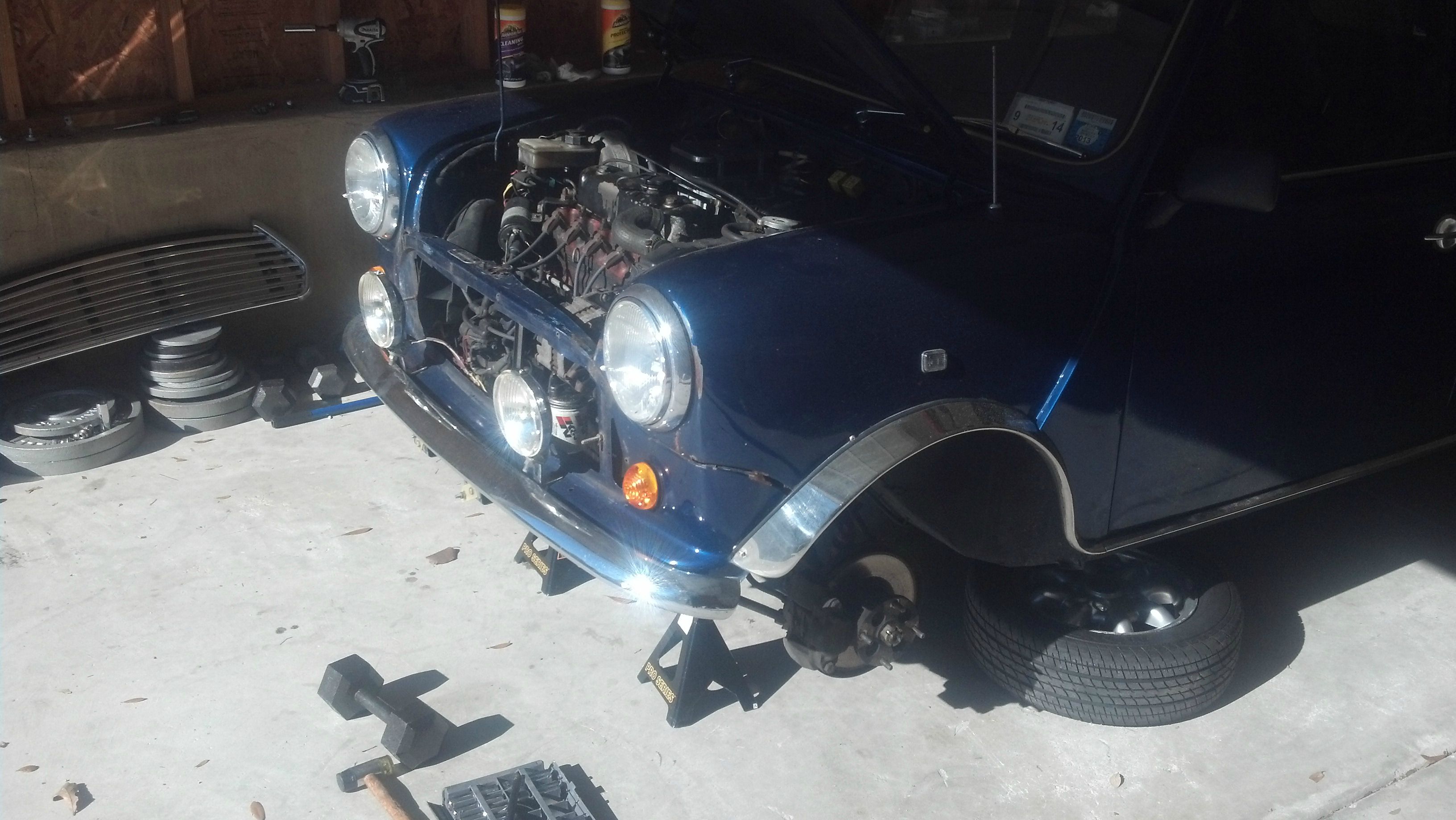

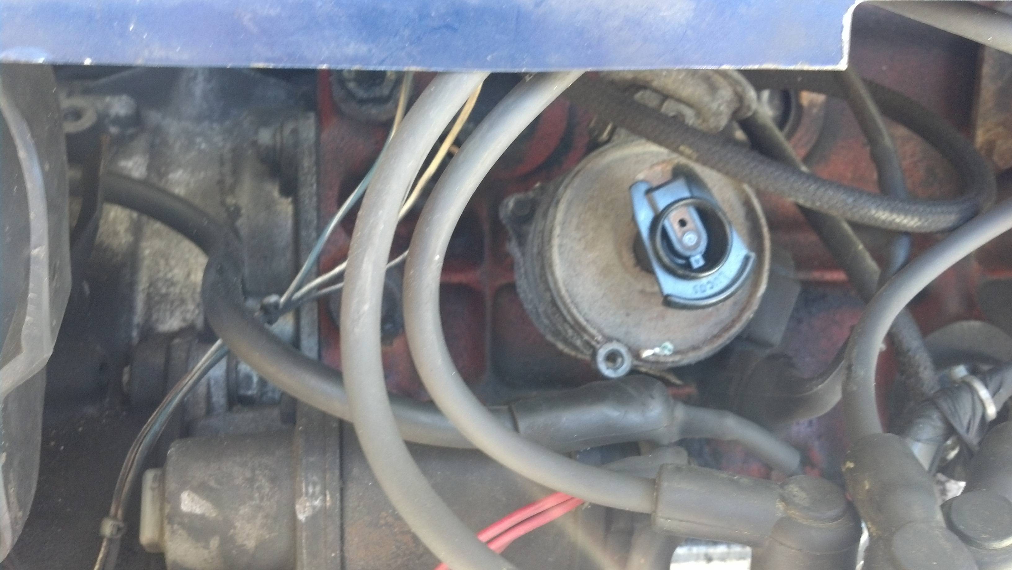

Looks like the dizzy is connected with the A+ fork, popped the cap, here's what's underneath.

Old Jan 20, 2013 | 09:04 AM
Capt_bj's Avatar
Capt_bj
Posts: 7,037
Likes: 283
From: Melbourne, FL
A few thoughts from your video
What fuel are you running - premium? Sounds like some knock is present at idle.
I hear valve chatter too - sounds like they need adjustment. Not a big job - easy to DIY with just a few simple tools.
What oil did you put in?
problems that come and go are always fun. locate the fuel filter - if there is one - and if there is replace it. how many times have you filled the tank since you bought it? Is it possible there's water in the tank?
I'd examine all the wires - the big thick ignition wires AND the thin ones that attach to that coil. A loose connection here can make the ignition pop on to off and back again . . . check the battery cables too, especially the negative one - BOTH ENDS ... where the neg connects to the body in the boot is a common place for you to have a loose bolt that makes the ignition come and go . . .
That looks like the Lucas 65 electronic distributor so no points to worry about. It still uses a coil so check those connections as they can cause problems like you had. Look for wear on the rotor and on the inside of the cap, where the rotor makes the contact to the spark plug wires. And learning how to use a timing light is a very good idea. You can get a cheapo at Harbor Freight for around $20 - it is good enuf to do what you need. You know what the dizzy clamp looks like - is it tight? If you can twist the dizzy that would be bad - that's HOW you adjust the timing....
