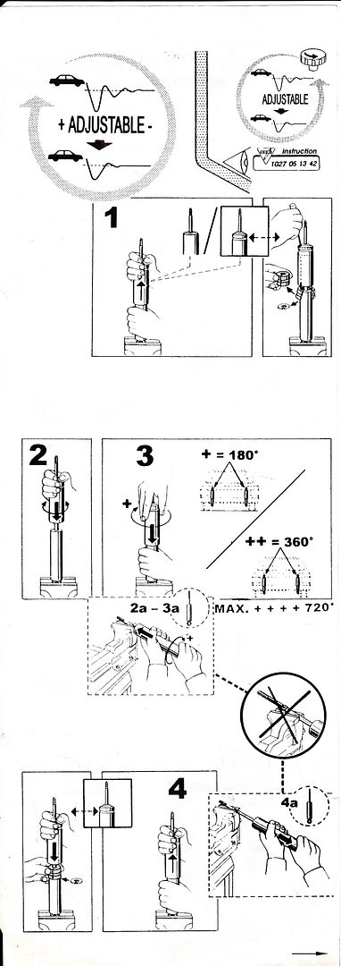

Can anyone point me to a tech article on how to adjust the damping on my red koni dampers? Or maybe a short explanation on how to adjust them. They came on my car so I don't have any paperwork.
From what I can tell, you have to spin the top part, but I don't know if they need to be fully compressed or extended while adjusting, and whether I turn CW or CCW for stiffening up the rate.

Jeff, see if this helps:
http://www.koni-na.com/cat_search.cf...&submit=Search
Also found this, although it might be hard to understand without text.

I found this article regarding setting compression and rebound damping on koni shocks. What I can't figure out is whether the red koni shocks have compression adjustment. The article you reference above only discusses rebound damping adjustment.
Do you know if the red koni shocks support compression damping?

As far as I know there is no adjustment for compression damping. I believe that would need to be addressed with specific valving.
