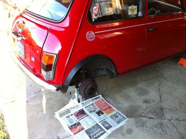

The day begins... So much potential...
Look how CLEAN everything is! (That won't last long...)

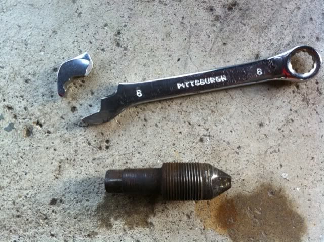

Got one side done, but the other side's brake adjuster was completely frozen into the backing plate. How frozen you say? Well, even after heating and multiple rounds of penetrating oil, here's what it did to my wrench
(NOTE: old, non-frozen adjuster from the other side shown for comparison - I'd like to find the person who designed this and introduce him to my friends Mr. Rubber Hose and Ms. Bicycle Chain... Grrr....)

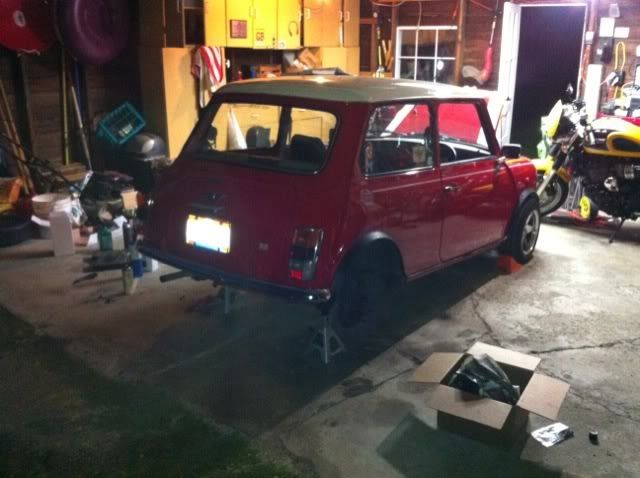

As the sun sets, I slink back to the house, defeated. I'll let the penetrating oil sit overnight, just in case. (Sigh)...

Does anyone know what size square adjuster wrench fits on that fastener? I got a 1/4" -7/16" on eBay, but I fear the 1/4" is too small and the other end will be too big. A 5/16 crescent or an 8MM fits on the flat facets pretty snugly.
Yes, get a 5/16 square socket - mine is from Craftsman. Use PB Blaster - heat if necessary. This is the same adjuster as my 95, 96, 97 (Sonett) SAABs.

All you can do is what you're already doing, rust penetrant and/or heat till it loosens up....
This might be a case where removing the backing plate and putting it in the vise might help, if for no other reason than you won't be all bent over to reach it as you work on it.
Good luck. Sometimes it takes up to a week for the rust penetrant to work it's way all the way in, just FYI.....
When you re-assemble it, be sure to use a light coating of good grease on all the moving parts of the adjusters.
Don't worry about that screw hole, it won't hurt anything......
there is a SIGNIFICANT strength difference 'tween a GOOD tool and a not so good tool.
I've bent cheap wrenches and come back to the same bolt with a GOOD wrench and gotten the sucka to move. Good: Craftsman (altho mine are old and I hope today's are as good), KOBALT, SNAP-ON certainly others
This is a case where there can be a BIG difference 'tween Harbor Freight stuff and GOOD stuff.
I see your wrench is 'pittsburg' ..... hmmm, go to Lowes and get KOBALT of the same size and you'll probably get away with putting a piece of pipe over the end to give you a long lever arm, without bending or breaking the wrench . . .
Don't get me wrong, I've spent a LOT of money on tools in HF. I recently replaced a compressor I bought at LOWES (KOBALT) with one from HF after the LOWES unit died in only 5 years and so far I like the HF one much better. But some of their hand tools are just not made from the same high strength steel as the good stuff and when you press a tool to its limit you want that limit to be high. The wrench I bent had served well for many years and after replacing the wrench I gave the set of wrenches and sockets to my son to be the base of his tools....very workable for everyday household chores. And bought all good stuff for me - {which happily I can afford now.}

Success!!! Managed to wiggle the adjuster back and forth till it broke free and managed to get it out. The vacuum bleeder worked a charm and the brakes are now rock solid. Went out with Amy for a nice drive and evening with friends - awesome. Thanks again for everyone who asserts with this!!
