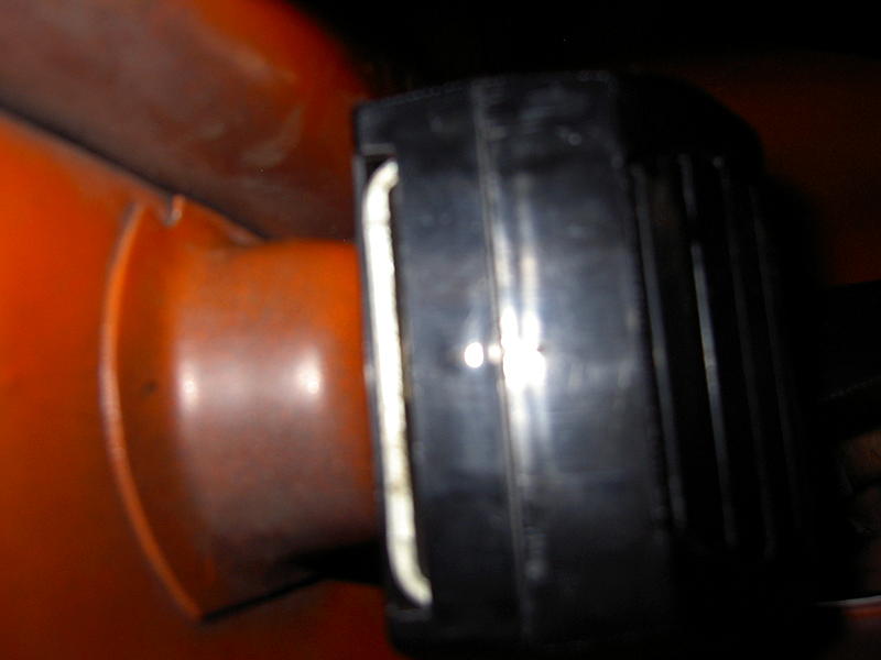

Still not getting anywhere with the seat belt retractor. It is a Kangol Euroflex V according to the label and I cannot find any information on it on the internet.
Here are some pix of how it is mounted in the pocket. The first pic is looking down in the pocket. The bolt goes into the pocket from the exterior side to the left of this picture.
This picture is taken from the right side of the pocket as shown above looking back to the retractor....
This last picture is from the bottom of the pocket looking up at the underside of the retractor.
I do not see anything to put a wrench on other than the bolt head outside the pocket. The bolt head just turns so if there is a captive nut inside the retractor it is not attached to anything.
The retractors do not lock when you pull the seatbelt forecfully; however, they do recoil the belt when it is pulled from the reel.
Any help is appreciated. These items are the only thing left in the car and stand between me and the bodyshop...........

That definitely different from mine then. The bolt is open at the bottom at the front of mine and bolts directly to the pocket. I don't have the round painted piece it attaches to.

And I think Madoc is right, there's a nut inside of that cone shaped part that's held by a couple of sheet metal tangs, they've been bent out of the way because someone used too much force to tighten it and the nut is turning. I'll bet that bolt is a shoulder bolt, and someone thought they should tighten it till the retractor didn't move anymore, but the retractor is upposed to be able to pivot on the bolt. Cutting off the head will free up the retractor, but you still have to get inside that cone to get the nut off - you might find stripped threads too.

As I poked around determined to find out how to access what appeared to be an injection molded housing with no means of entry and find the secret access to the internal nut, I discovered the following:
This retractor unit....
Could be persuaded to look like this......
No captive nut - just a simple access hole nicely concealed on the lower front of the unit - invisible in the dark recess of a Mini rear pocket.
