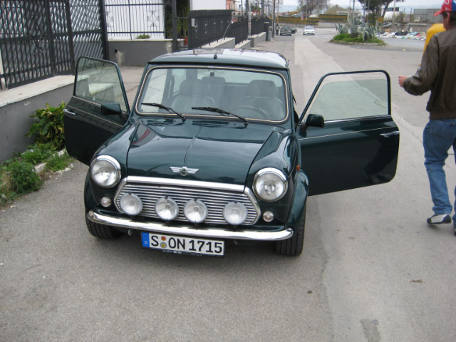

Help me ID the build year of this car, please!
Hello from Bella Napoli!
A gent who claims to be the second owner advertised this car as a '98. But, looking at the VIN, I'm skeptical. To me it looks like a 93. I've been able to decipher all the other characters in the VIN, and his registration (in German) appears to show it as a '98. The car is in good shape, and I want it; but I also want to be certain that I'm not being bamboozeled....
Thanks,
Jeff

THOSE are LITTLE THINGS. if it was a 93 it would probably be Spi, But yours looks like it's MPI

Elprofe, appreciate the input. By VIN it is an MPI....
But, being new to the Mini scene, in other words a newb, I'm quickly gathering information on this car. I'm not certain when the MPI motor started being produced - another lead to track down the model year....
Thanks again,
Jeff

It looks like a 98.
The Mpi started production in late 1996, the easiest to spot signs would be a front mounted radiator, an airbag steering wheel and that roof aerial.

Andy, thanks for your help. Another talk w/ the owner
Originally Posted by Andy Simpson
It looks like a 98.
indicated that the car was built in '97. Based on the fact that the VIN indicated an MPI motor, I'm now looking for typical problems w/ these engines....
Thanks for the assist....
Jeff
