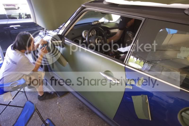

Hey guys, this is Alex... Im the redheaded Helix guy who you saw staring at this car for 4 days trying to make it completely green. Took some pictures along the way and wanted to post them up.
Thanks to everyone who stopped by and encouraged the helix team to continue on the build even through the late hours. I am very proud of how the car turned out and I hope you enjoyed watching the transformation.
BEFORE:
AFTER:
