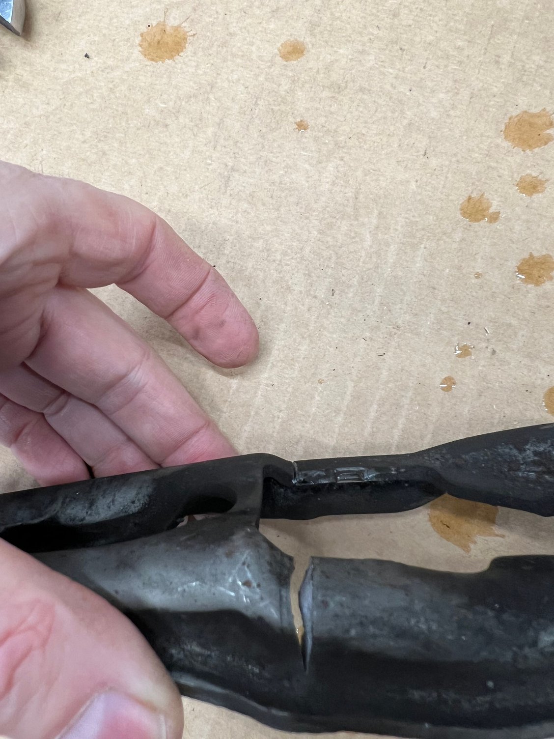

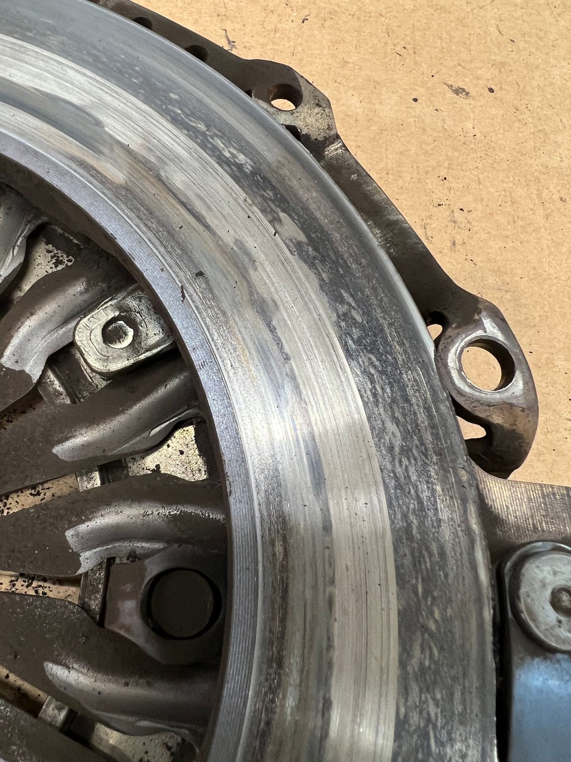

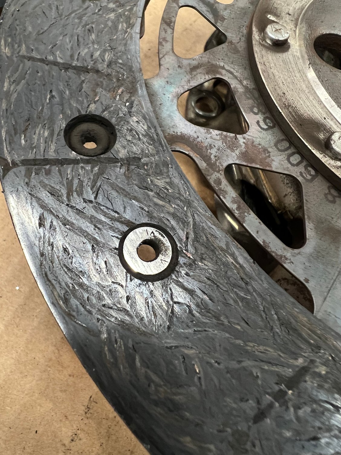

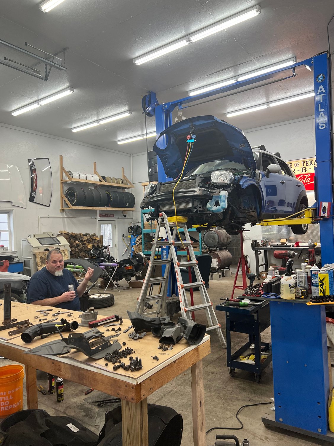

So after ordering many parts and a lot of messing around, the clutch is changed. The dual mass flywheel was shot, the clutch was down to metal rivets, and the fatal shot was that the fork broke and bound up on the pressure plate. I just went with a Sachs dual mass flywheel and clutch, new fork, pivot ball, clutch master, line and slave and we are back in business. Many maintenance items along the way. New air/cabin filters, oil change, trans/transfer case/rear diff oil, the cooling system flushed until perfectly clear and new coolant, new serpentine belt and water pump pulley, brake fluid flush and brake service (no parts needed, everything over 90% but made sure everything moving freely as it should), new spark plugs and topped it off with some new 93 octane gas and a can of Sea Foam. The car started up on the first crank and runs really smoothly. The AC was not working and the compressor clutch was making some bad noises so I ordered off a new compressor. Test drive went smoothly once I got the heat shields in place and all appropriate sensors plugged in. I am really impressed for a car with 113,500 miles, there was no creaks, groans or rattles on the original suspension.

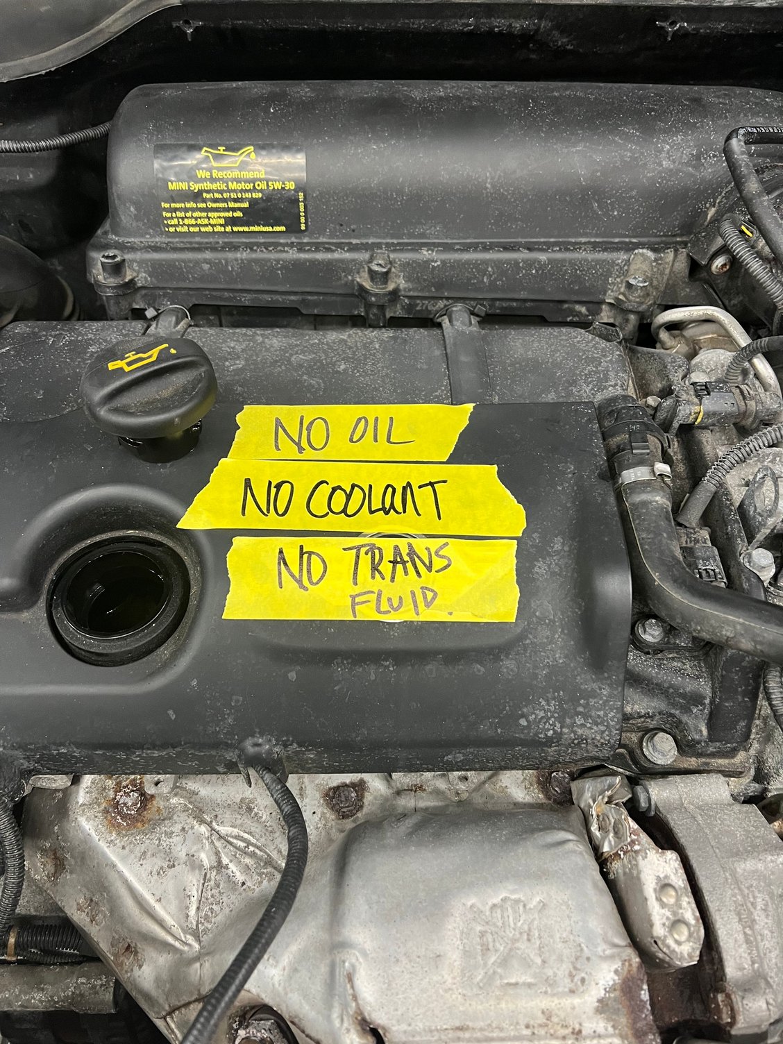

All set up and organized
I am perfectly capable of making stupid mistakes. I try and minimize the chances.
Split right through.
Original clutch worn down to metal.
You can see where the rivets were wearing on the pressure plate.

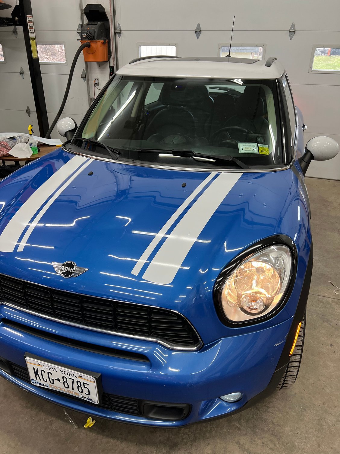

Made up some white vinyl graphics and installing them.
Finished product.

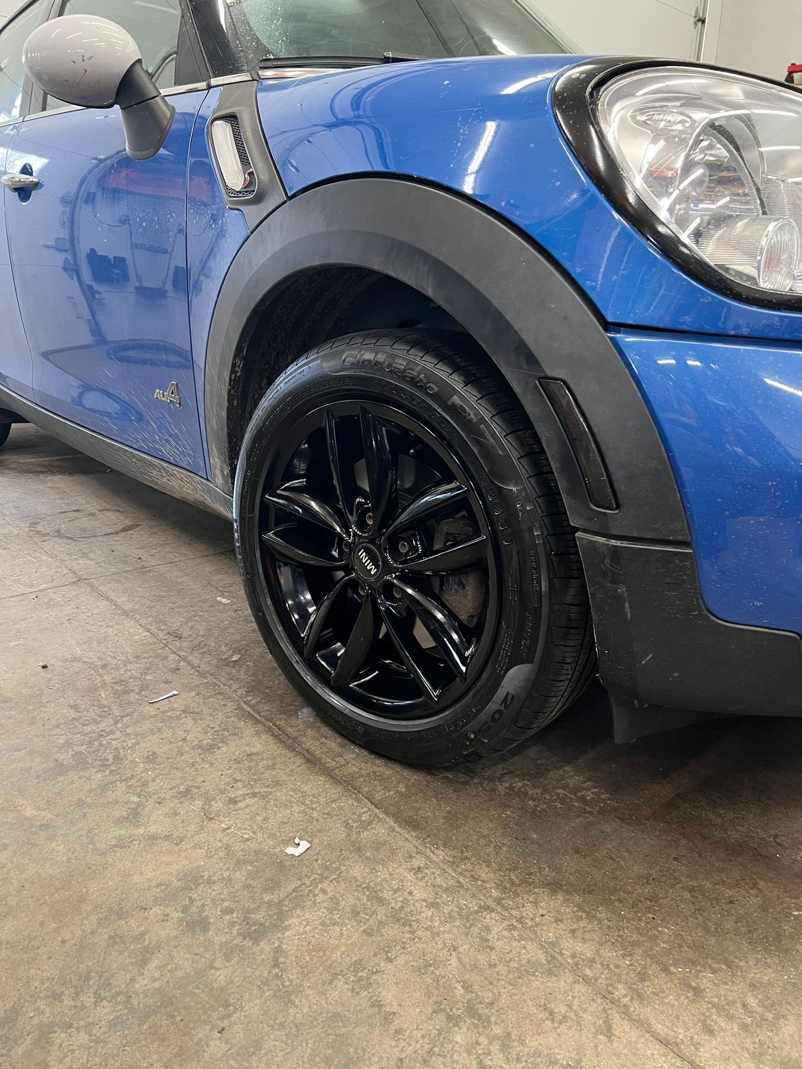

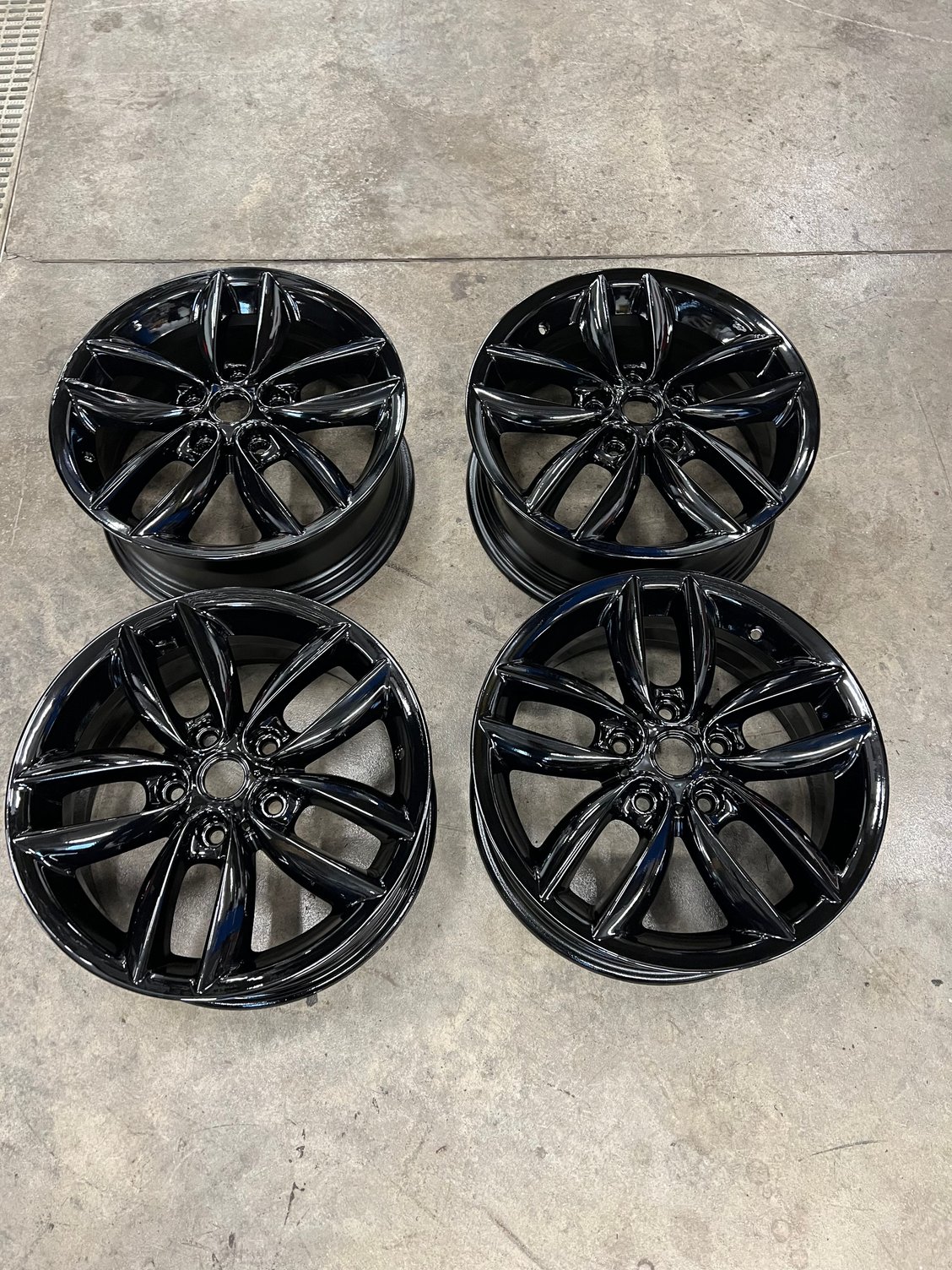

Repaired all the curb rash and powder coated the wheels.
Mounted, balanced and installed. Getting rid of these tires. Way too small. Going to get 225/55-17 to replace.

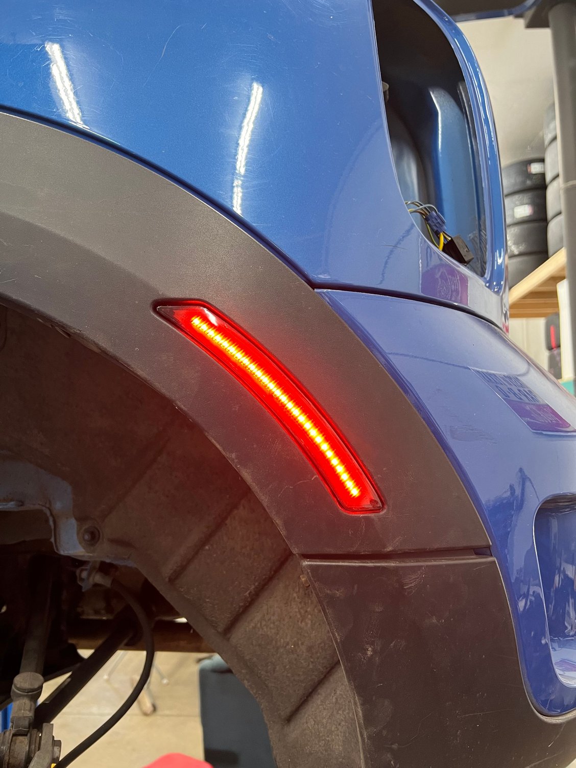

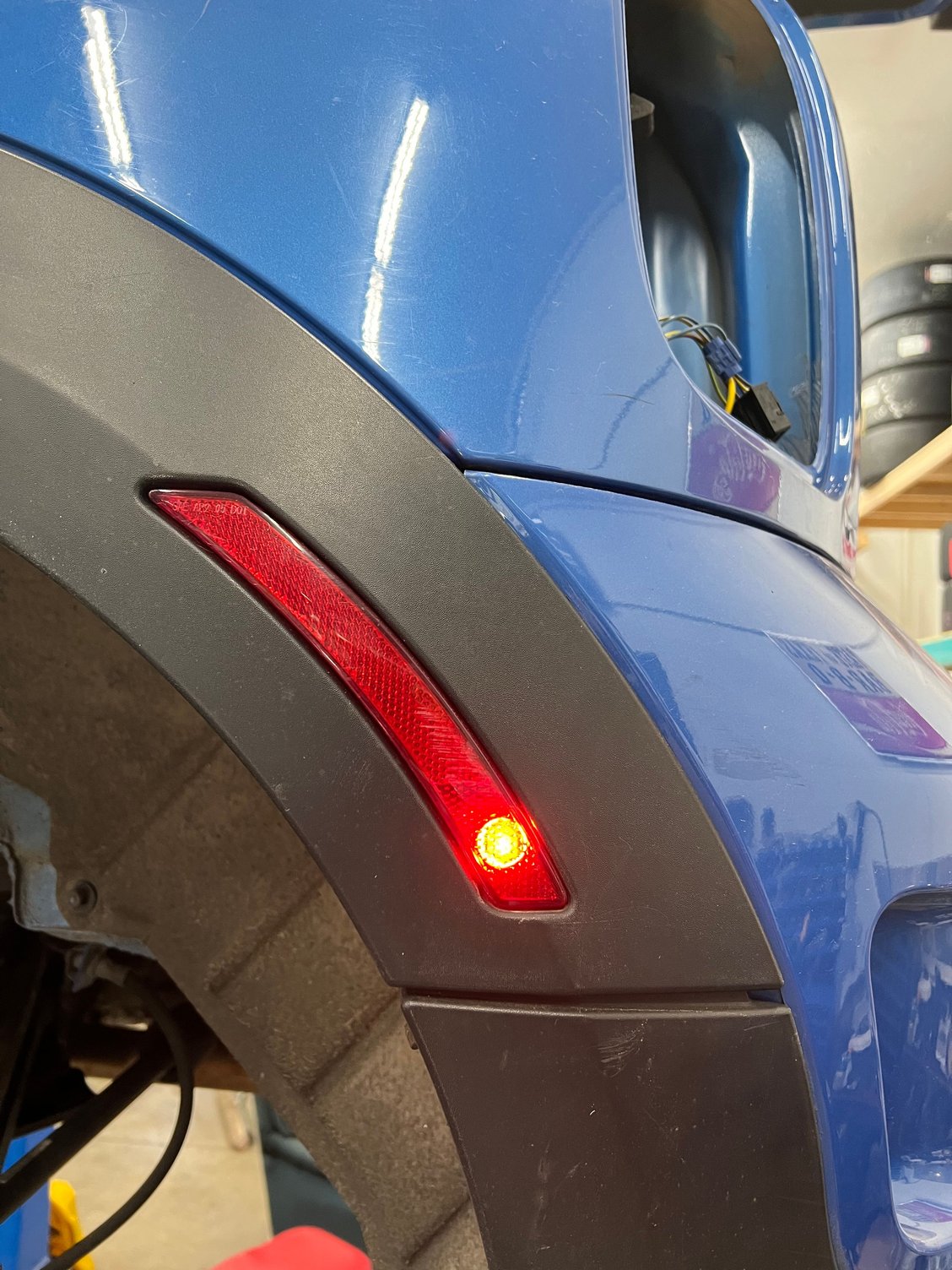

Horrible corner markers and two completely broken and corroded.
Some new connector ends compliments of a donor mini behind the shop and new LED lights. Much brighter and visible.
