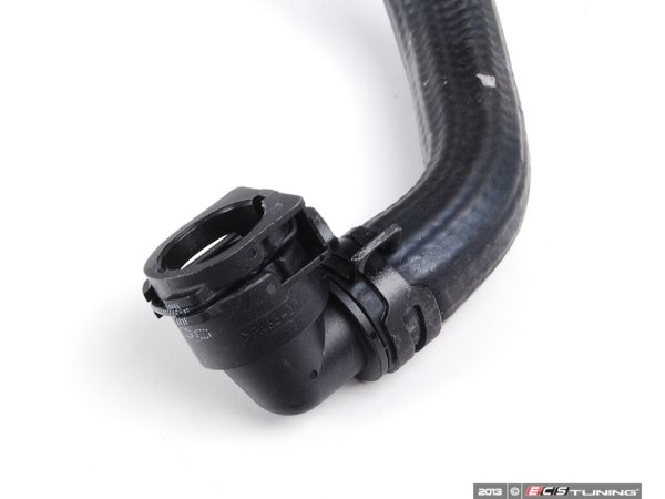

• Secondly, when I moved the tank to get to the oil filter, the tube below started to leak, maybe from the bending? I didnt really investigate, other than "whoa, better not move that thing too much"....something I should repair or have repaired?

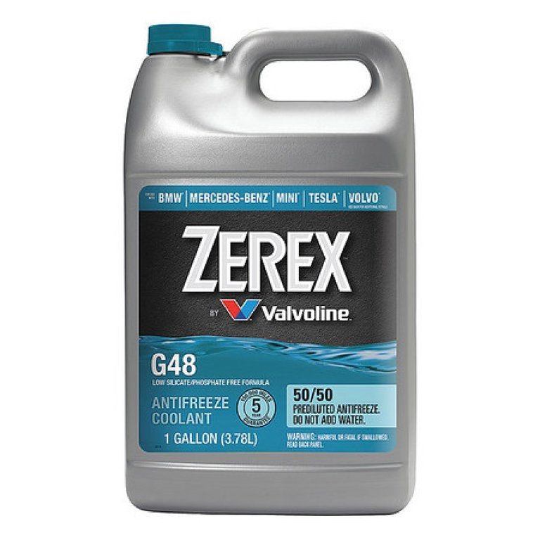

Zerex G48 can be found at O’Reilly’s. It will say bmw/mini on it
or make sure it’s the European blend for bmw/mini

G48 eh? I scoured the manual and do not see specs for this mini, but I saw somewhere on the net that said G11.
https://www.ecstuning.com/b-pentosin...space-g001100/
if it’s this then your fine, there are a few manufacturers that use the same codes. I run the zerex g48 in my R55s and friends R60S. She called me from autozone and said they had g11. I didn’t realize it was pentosin which would have worked.

Thanks for the update, also note if you leak at the neck connection here is the fix: https://www.northamericanmotoring.co...ant-leaks.html

@ECSTuning super helpful on that other thread with the neck connector, ordering now.
May be silly to ask, but, the genuine MINI doesn't seem like it's all that great? I mean, mine is 10 yrs old haha....debating on the off brand or MINI one.

The other brands are good. Elapast is the oem manufacture for that MINI hose end.
https://www.ecstuning.com/b-elaplast...537600674~ela/

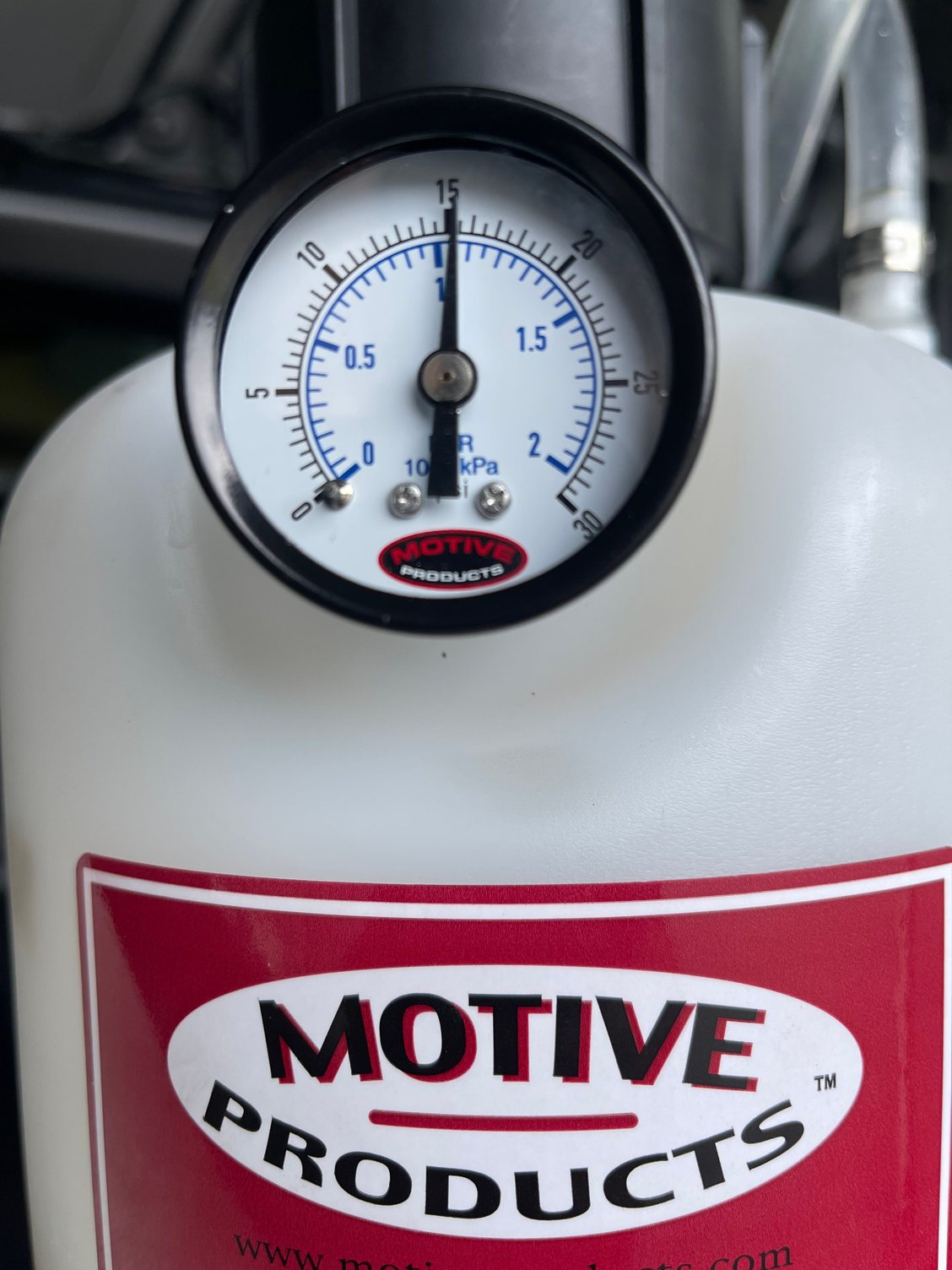

Buy a motive power bleeder for your brakes, not only will you be able to bleed your brake but you can also pressure your coolant system at the coolant tank. This one pays for itself.
This is when I did mine

I see a bunch of those models, have one you recommend for Mini?
https://www.motiveproducts.com/colle...c-bleeder-kits
Old Jan 28, 2022 | 01:03 PM
Jason Cornelius's Avatar
Jason Cornelius
Joined: Dec 2019
Posts: 2,107
Likes: 691
From: Cincinnati, OH
Originally Posted by stiksandstones
i see a bunch of those models, have one you recommend for mini?
0100 european power bleeder

Got that power bleeder, put it up to 10-11psi, as not to 'break' anything haha, didnt not hear or see any leaks.
I am gonna assume, I am over reacting to the level on the reservoir hahaha.
I turned the bleed screw, 3-4 turns, and saw some coolant come out and then tightened it, was hard to see and clean up the little bit (without taking off all the parts to get to that screw).....so, will assume I have no problems and just keep an eye on it haha.
Thanks all.
