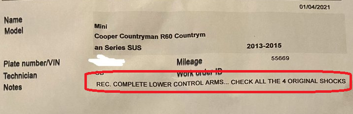

Alignment went wrong?
I had an alignment service for my 2013 countryman s and I still feel like the car leans toward right passenger side on the street. I posted the service paper. Please let me know if they did wrong.

did they talk to you about control arm concerns? Not unusual to need to replace bushings in lower control arms ....
the technician said it's just recommendation for 7-8 years old cars so I'm not really sure if it needs new control arms. Is camber specs fine?

Does it feel like it's leaning in a level driveway or parking lot? You might just be feeling the natural crown in the road, combined with a taller car with a higher center of gravity compared to your previous MINI. Also, have you measured the ride height to see if any corner(s) is/are sagging?

Sorry to say this, but this is a very poor alignment. Rear axle values are missing, meaning that guy did nothing on rear.
Not only this, but it's hard to measure front without doing rear before. Even more, front toe in is increased. Values should
read half of that. This suspectedly does make the effect of the increased right/passenger side front camber even worse.
You certainly want them to do their job right or get your money back. Hope you get it sorted.
