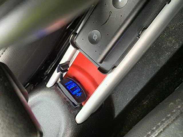

Makismou, here are a couple of pics; one of the joystick and button controller removed (plastic plugs installed) and the new USB ports that replaced the cigarette outlet and the OEM aux-in/USB outlet.
Really nice job overthere...
