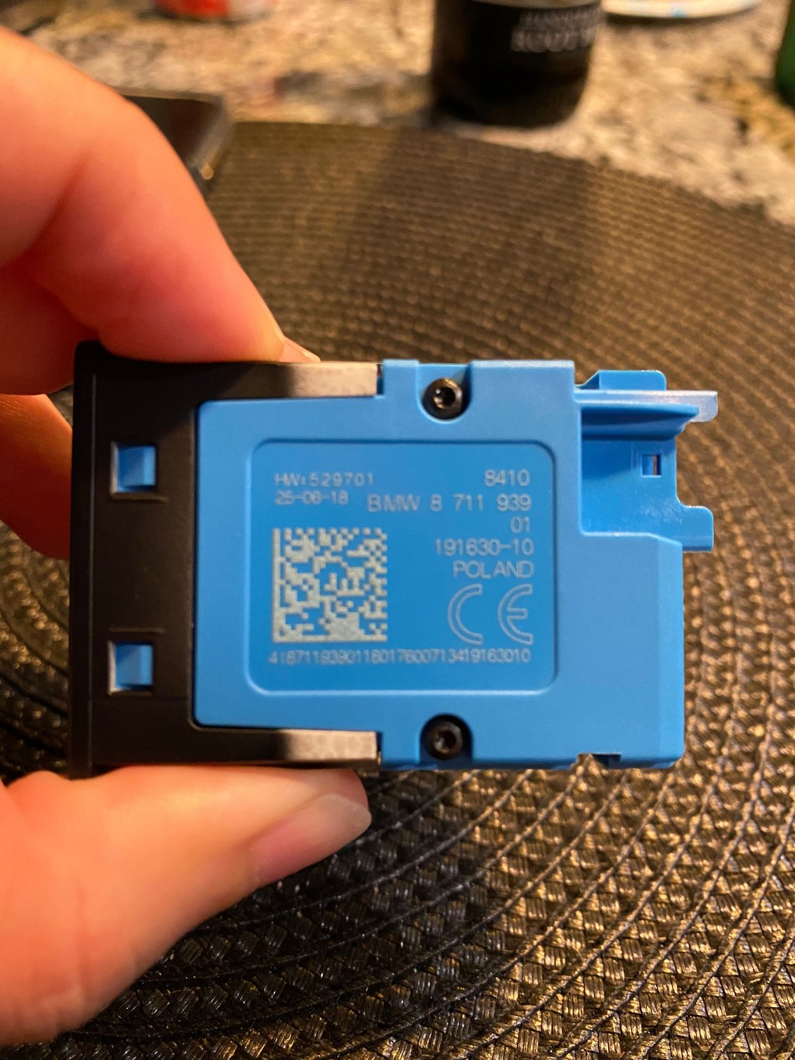

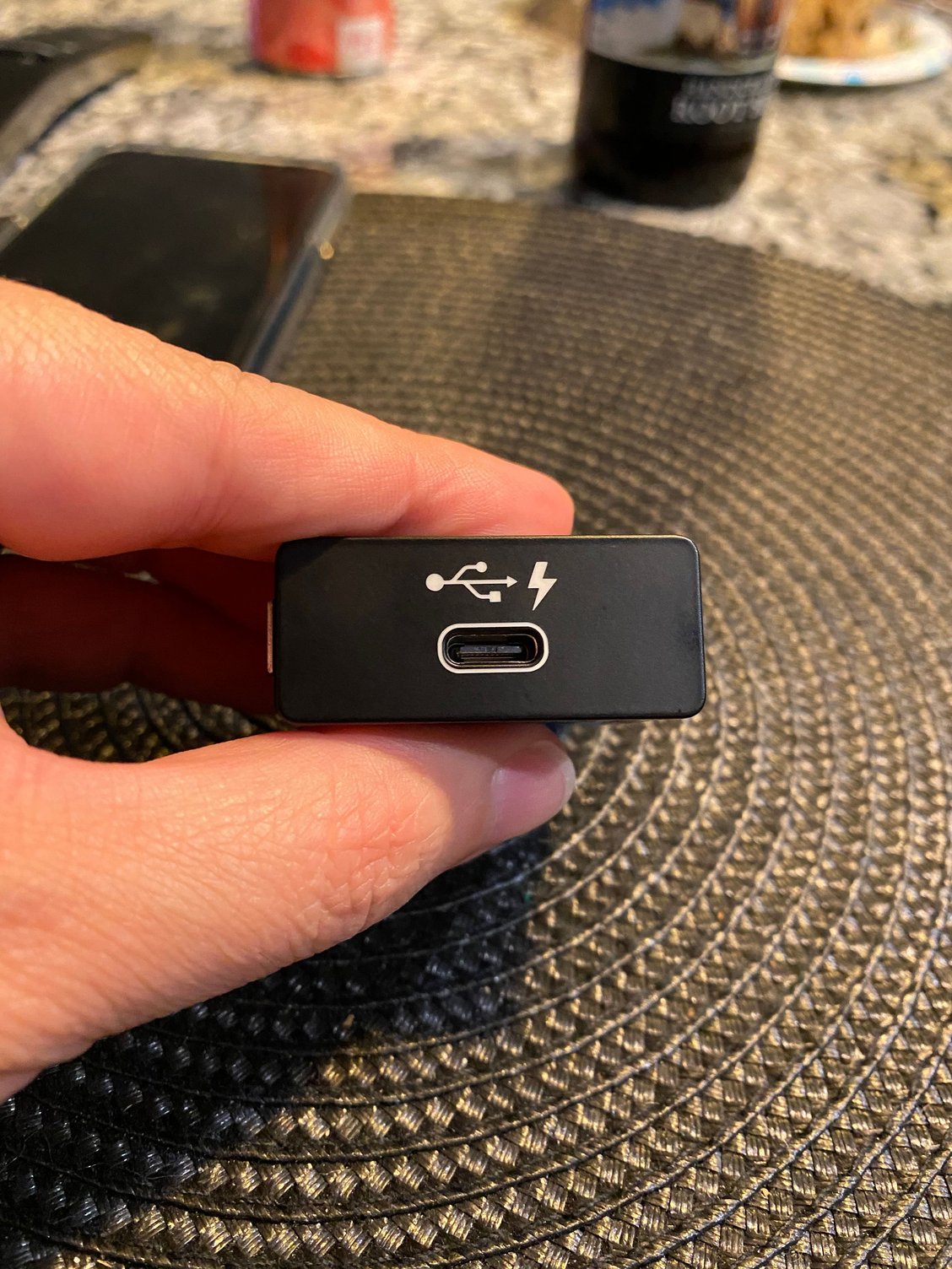

Hi All,
Any chance anyone has seen the wire harness for this unit? The current one I have (USB A + Aux, white plug) doesn't work. I’d love to retrofit this in the MINI. F60 and F54 has these.

those are for the F54 and F60s. 4 pin plug is just power and ground to power the Apix data line which is the HSD cable next to it. not a hard retrofit.
