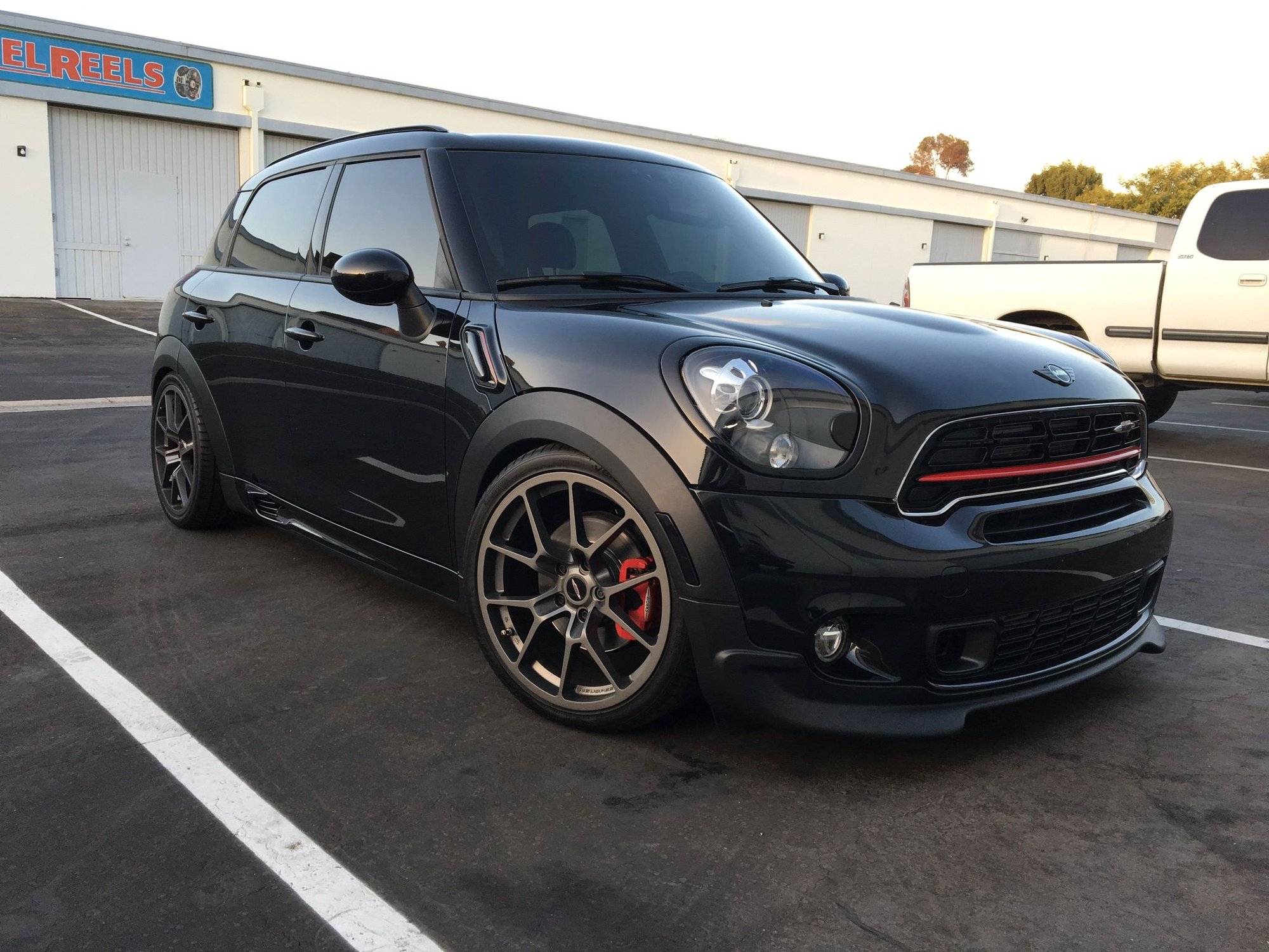

Congrats on the Countyman. I have my 350hp Countyman AWD manaul.
I have tuning and lots of go fast parts
Mario
