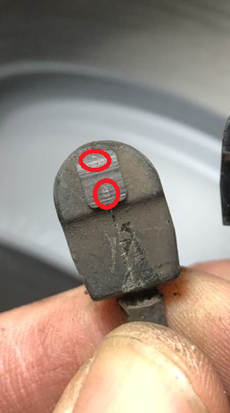

No replies, so I figured I would just swap out the sensor and see what happened. That fixed it. With the new sensor, I was able to reset the service interval for the rear brakes back to 37000 miles. So if anyone else has this issue, the brake pad wear sensor seems to be more than just "replace pads now." Here are pics of the old and new. You can see the old has some wear, but it's not worn to the point that the circuit was broken. Yet somehow the sensor detects wear and alerts you to get ready to change the pads.

actually it IS worn that much
look very carefully and you can see the nubs of the wire loop .... the connecting segment is gone.
I completely dissected one .....
