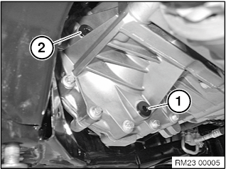

Did you figure out how to remove the R60 all4 manual fill plug
@dmath, did you figure this out? I'm trying to do the same. I've been researching this vehicle and there's very few diys out there on this. It is not the same as R56-R59 as far as I can tell. All I can assess is there are two options, remove the subframe brace AND possibly disconnect the exhaust pipe to get to the fill plug or fill it from the vent near the shift linkage on the top. The later requires you to measure the exact amount of fluid to be added. This appears to be the vent cover. I've seen this method used in a clutch replacement video. Did you use either of these methods?

Here are the two plug locations, looking from under the car:
The fill plug is #2, and the drain plug is #1
Always check to see if you can get the fill plug out BEFORE releasing the drain plug.

It became a non-issue for me. About a month after I last posted in this thread, before I had time to get back to working on this, the car needed a clutch. So I punted and had the transmission shop replace the fluid. All I can say is that the fill plug on our R61 was not positioned like those in any of the photos I found online. I was under the car multiple times and looked at the transmission from every angle. Good luck.
