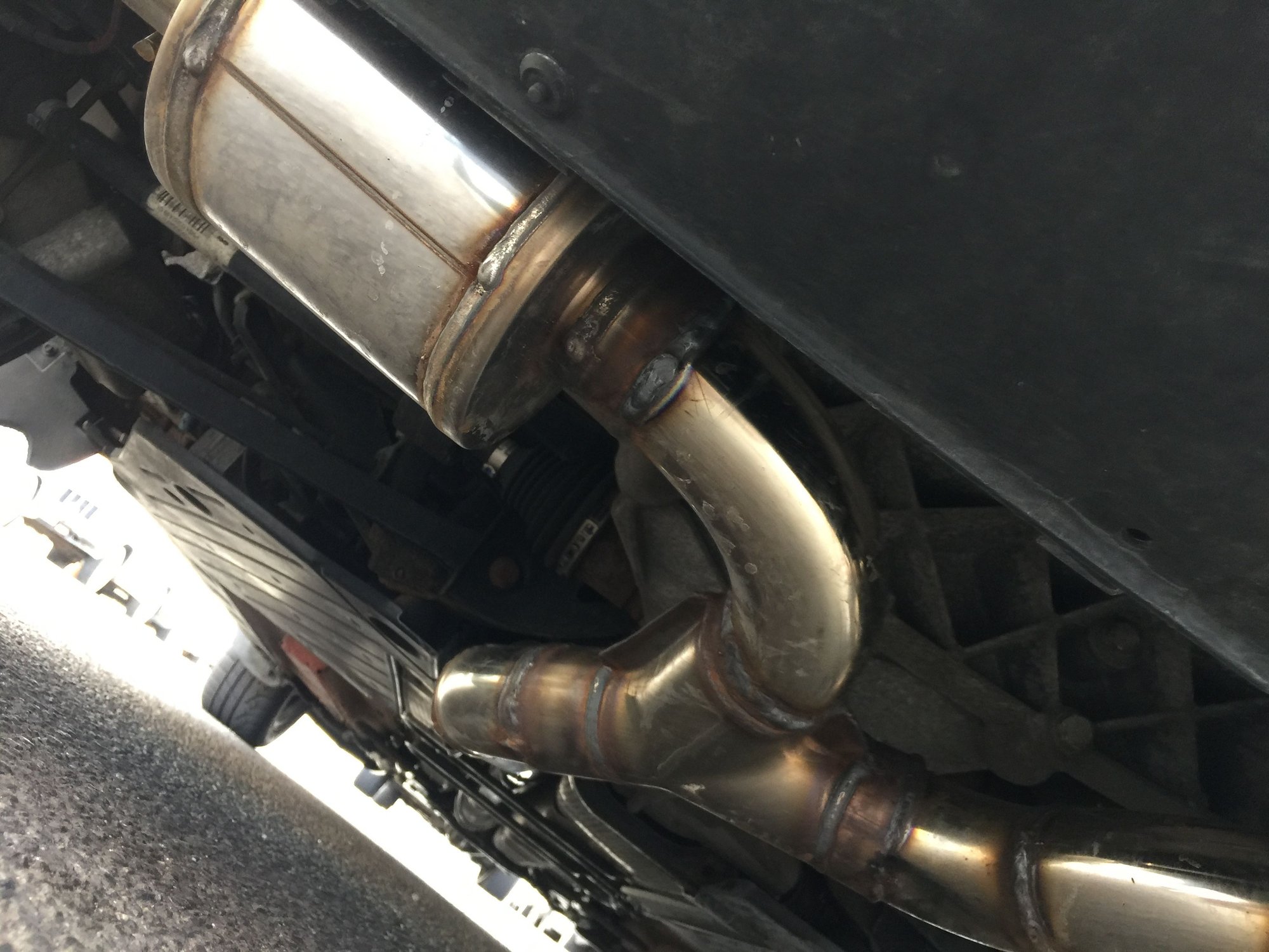

I have the Magnaflow installed on my R60. I had my local exhaust shop perform a res delete and full 3" piping with a Magnaflow muffler. Sounds incredible and a lot cheaper than the bolt on kit from Magnaflow.
If you’re not going to Tune your Car, you can keep your OEM Catted DP and Flex and remove the 2nd Cat. Leave the OEM Resonator and Pipe the back to the Dual MF Mufflers and you will still get the sound you’re looking for.
The key to taming the drone is either the OEM Resonator or a quieter Aftermarket (to cut down the rasp) and the muffler tips have to extend past the body 1”-2”
While I know the following might be slightly out of your budget I thought you could use it as a tool to see where the money goes
Milltek Catless Downpipe - $250.00
Scorpion 2.5” Flex Front Pipe - $215.00
Vibrant 2.5” Ultra Quiet Resonator- $89.00
MagnaFlow 2.5” Y Pipe - $40.00
2x Magna Flow 2.5” in/out Resonated Race Mufflers - $139.00 x 2 = $278.00
2x Budget CF Tips from e-Bay - $28.00 x 2 = $56.00
2.5” Pipes - $200.00 ish (Was a gift from a friend)
Muffler Shop - $150.00 (but I also did some of the welding and fab work, so this can be more)
I have an Awesome sounding Countryman now. Drone is Minimal. I can still have a conversation without screaming and listen to music
