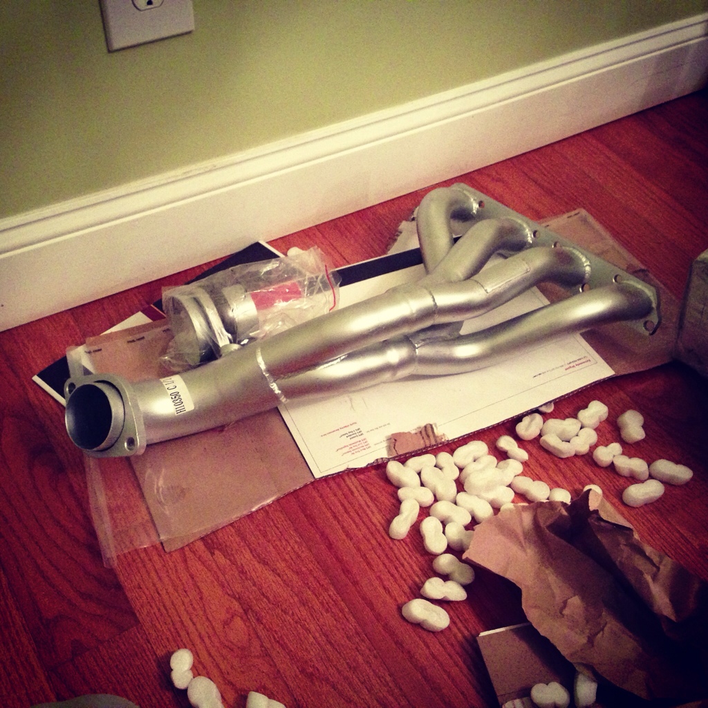

OBX ceramic coated header
Pre cat delete with the OEM catalytic welded to the OBX

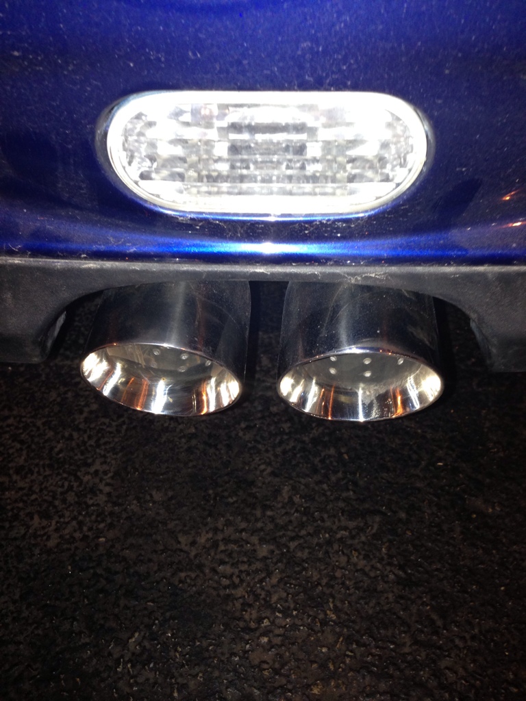

One ball mod with refreshed tips

The header cost me $180 shipped, I have to admit that I was a bit afraid it'd leak since it was so cheap..
Also make sure the welds don't get in the way of the nuts, I heard that some people go through hell shaving some of it off in order to fully bolt the header on.. Mine seemed to be fine, but still if you're getting one of these keep an eye out for imperfections .. Best is to have it installed before the return policy is up..

The one ball mod was quite simple, they removed the rusty muffler on the right side and simply welded a left elbow to the left muffler.. Also, they gave me new tips, I believe they're 2.5", I don't quite remember.. This was all a couple months ago.
