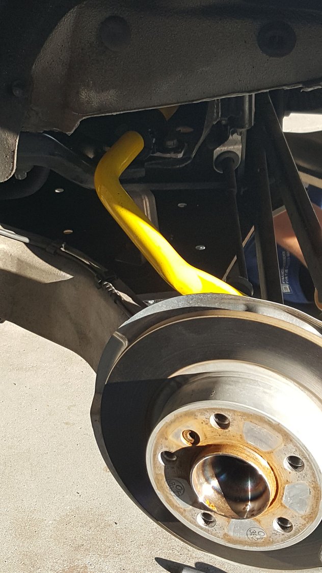

My CM, post mods.
Originally Posted by Nick89
Thanks very much for a very comprehensive answer. I am still waiting to dip my toes in the water, and start the job.
Good luck! There was one other thing I thought of after the previous post: I'd strongly recommend that you get a set of the lowering springs for the R60 from NM Engineering and do those at the same time. That said, MAKE SURE YOU GET A STEERING KNUCKLE SPREADER FIRST! (
Amazon.com: Astro 78205 Universal Steering Knuckle Spreader Tool: Automotive Amazon.com: Astro 78205 Universal Steering Knuckle Spreader Tool: Automotive
) Otherwise you're going to spend about an hour trying to figure out how to get the bottom of the front struts out. Prying them apart and attacking the front strut with a rawhide mallet sucks. Trust me.
The reason I'm recommending the lowering springs is that between those, the swaybar, and a front strut brace (I have the Monster brace from M7, https://www.m7tuning.com/m7-r60-r61-...brace-kit.html) you're going to notice a substantial improvement in performance. It will make the ride quality a bit harsher, but the car is far more confident under very hard cornering.
There seems (IMHO) to be a bit of float in the rear end during aggressive cornering that those parts completely solves. I haven't tracked the car yet, but I can tell you that you will likely find yourself taking corners much faster.
Going through some of the roads here in San Diego are pretty amusing. I made the drive to Julian through Warner Springs a few weeks ago and found myself wishing for better seats to avoid having to brace on hard corners.
