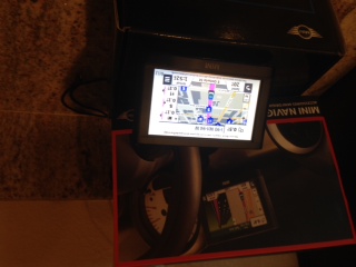

Picked up the portable MINI Nav by Garmin today. Should have this installed within the next few days and will post pictures once installed. It is fully voice activated, HD Screen, Bluetooth and also has traffic and is upgradable.
Works with CM power supply and mutes sound when active.
Below are the part numbers if interested:
65-90-2-348-018 GPS, MINI Portable $225.25
65-90-2-351-408 Installation Kit $131.75
65-90-2-348-476 Bracket $13.00
I will post pictures once installed.

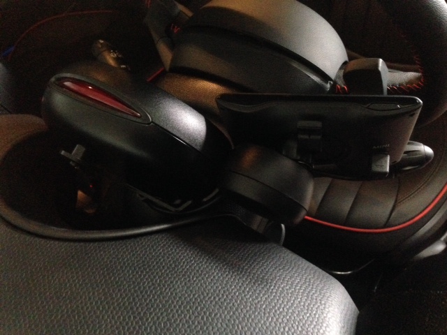

Installed the MINI Garmin Nav, Nuvi 2497 today and looks good. May not be as fancy as the factory install but the voice command works really well, easy to see and use and it looks right at home next to the tach.
Like the customization and the cost was minimal compared to the factory option. For those who may be interested the Nuvi 2497 also allows for free lifetime updates. Here are a few pictures showing the profile, side and back views. Clean look once all is installed and put back together. Took about an hour to install and wasn't to difficult.
If anyone needs the instructions let me know and I will post.
Happy Motoring!
Chris

Any way to mount it differently? I found the steering wheel cuts off the left side of the display if I don’t lean over to the right like in this pic... :(

Some problems with the Offical Mounting Kit using a Garmin 2497:
1) The left upper GPS corner is totally blocked by the steering wheel.
2) If you move the GPS to a position where it is not so blocked then you hit the GPS when you use your lights stalk to turn right.
Seriously, thinking in how to move the GPS to the dashboard vent grill...
